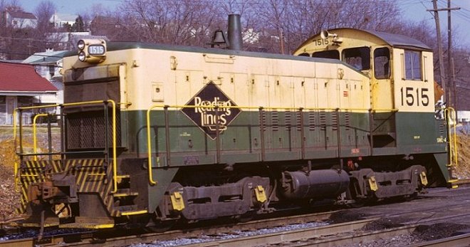

Reading SW900 #1515 in West Wyomissing, PA.  Photo courtesy Kim Piersol.

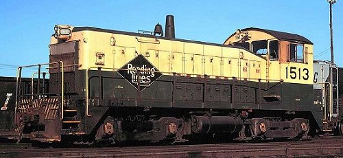

Reading SW900 #1513.  This locomotive is from the second group of SW900s to be delivered to the Reading.The second group of SW900 locomotives to arrive on the Reading were five units numbered #1511-1515 that were delivered in December, 1963.  These units were classed SWE-4, and were delivered in the second-generation yellow-and-green paint scheme.  It is important to note that these SW900s were delivered new directly from EMD, and were not rebuilt from older Reading locomotives.  These units worked primarily in the Philadelphia, Coatesville and Reading areas, and lasted into the Conrail era.  None were known to have been repainted into the 1970s Reading Green scheme.

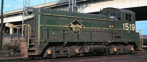

Reading SW900m #1519 was the only SW900m to be repainted into the Reading Green paint scheme.When rebuilt, all units were initially painted in the yellow-and-green paint scheme.  However, #1519 was repainted into the final Reading Green paint scheme in 1972, as shown at left.  Like the other SW900s on the Reading, these units saw service in Philadelphia, Coatesville, and Reading, and all 6 survived until the Conrail era.
