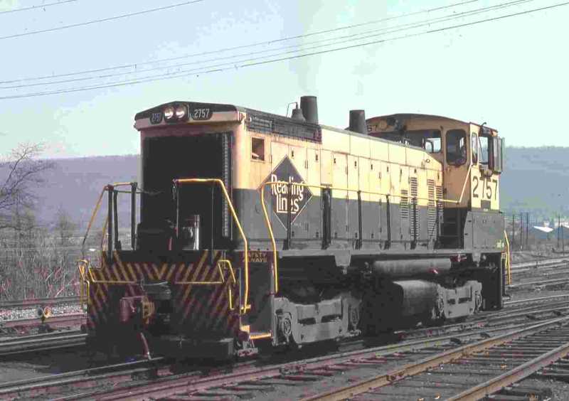

Here's thee 2757 at Water Station, in Reading, showing the typical pilot treatment after the footboards have been removed.
I think kitbashing is easier in 1 to 1.
