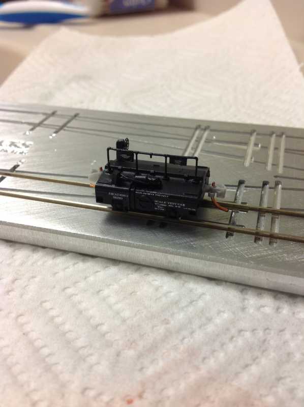

Told you guys I had it somewhere...Had my wife send me half of my cars from home to work on, and this bad boy was lodged in thre too!
Here's the story:
Started off as a true-to-scale model from Micro-trains. Was stripped, and then i went to work. Took a brake cylinder from a gondola or flat car underframe, drilled some holes to fit .08" brass wire and went to town. basically used a small file to jig the small radius bends to mate where I needed them to. Just used my best eye judgement while following the pictures. Then I CA glued the wires in place, and the hanging signs were glued, then the brake wheel bracket (Which I plan on replacing this week with a much thinner and anatomically correct bracket from a flat car. I didn't have one when I did this model.
I custom designed and printed the decals for all the lettering. Painted the model black, glossed it, decaled, and flat coated. I need to work on the couplers because i wasnt able to tightly body mount them like I should, so will probably end up retapping the hole and CA gluing them in. Then the model will be weathered, and done!
