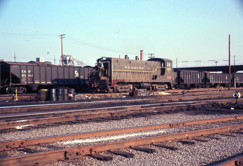

Just for Ron, here is 2707 at Port Richmond in 1967.
September 6, 1945
