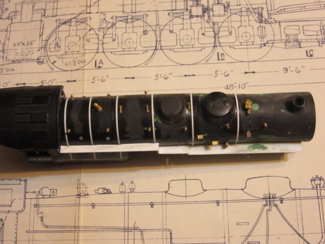

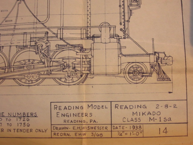

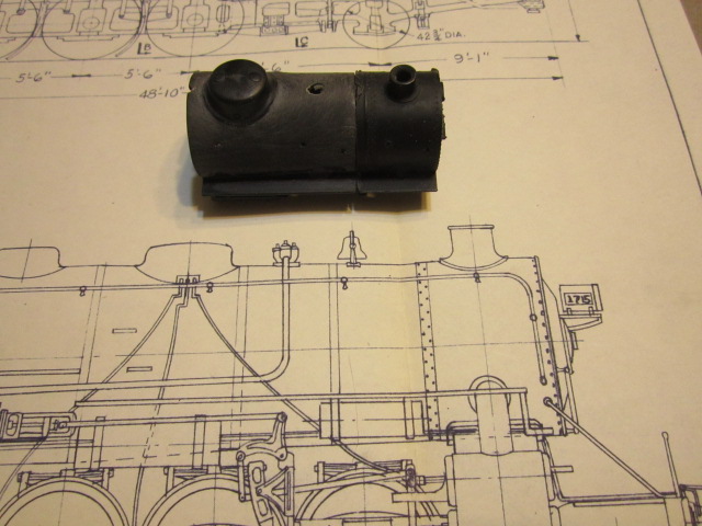

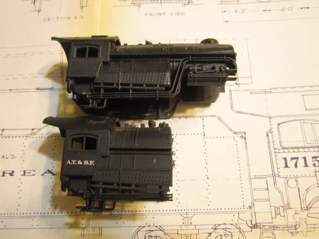

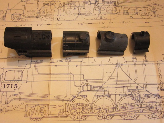

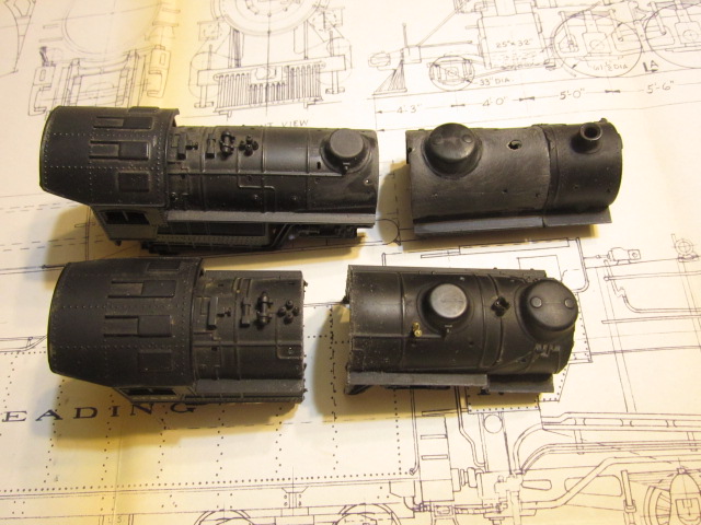

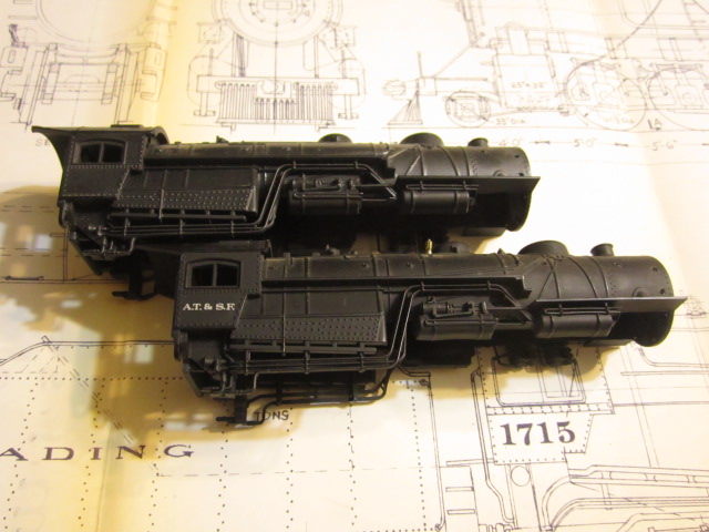

Mr. Bill and I talked back and fourth on this for a while, discussed options on how to do the boiler build, and came up with a pretty simple idea. Now, having the Wiswesser "O" scale drawing to work with made life easier, and combining two Bachmann I-10 shells work progressed. The first batch of photos show the initial stages. There is approximately a scale 6'6" addition to the smoke box from the donor boiler. There was 9" removed from between the sand and steam dome of permanent boiler. When I cut the firebox I left 2'9" on the permanent boiler, then used a full firebox from the donor and grafted together. I used simple ABS glue found in the plumbing dept of any hardware store. An important note, I left the detail intact strictly for re-alignment. Enjoy!!!

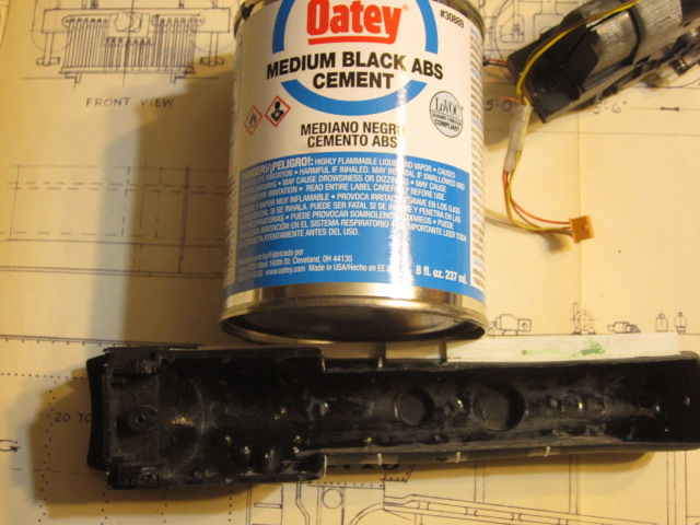

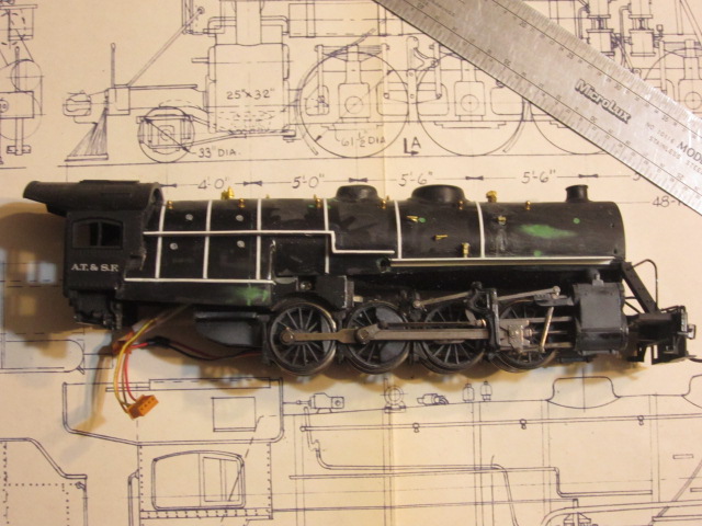

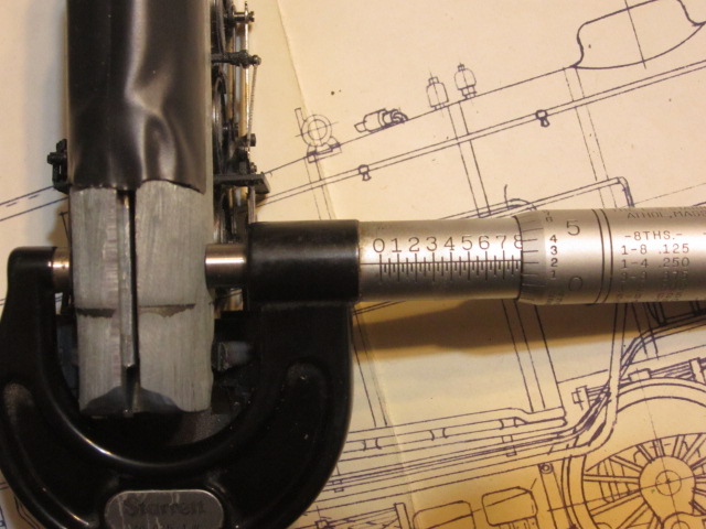

A few more details, I shaved some metal off each side of the frame, opened up a groove for future wiring, and as the micrometer shows .802 makes for a nice easy slip fit of the shell. The glue I used to attach each piece, and some careful cuts yield a superb job!
