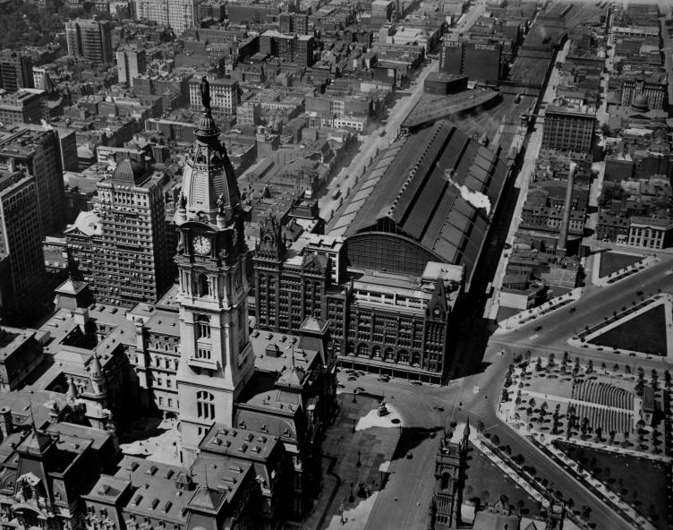

http-planphilly-com-eyesonthestreet-wp-content-uploads-2012-10-2017-1920-broad-st-station-bwsm-jpg.752.592.s.jpg
Reading MU cars, Paint and other things 10 years 5 months ago #5318
Wayne Jct. towerman- you do know the photo that you posted is of the PRR Broad Street station looking west toward 30th Street, and not Reading Terminal.
