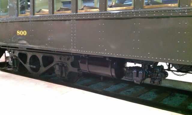

Reading MU cars, Paint and other things 12 years 11 months ago #2091
  • HHS
  • HHS's Avatar
  • Posts: 54
  • Thank you received: 40
Picture of the 800 at RRMofPA.
September 6, 1945
