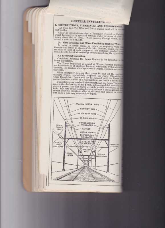

Here is the drafting image of wire and pole structure from the RDG ETT
Reading Electrification dimensions/blueprints? 13 years 2 weeks ago #2191
  • jdamelio
  • jdamelio's Avatar
  • Posts: 17
  • Thank you received: 3
It's not quite the same as the diagram on p 19 of ETtRT, but very close. My diagram has a signal transformer which I couldn't make out in the ETT.
