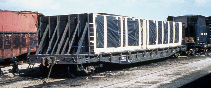

First off fantastic job on the flats, I always enjoy studying your weathering techniques! Now, plasterboard loads. Given your modeling ability I shall supply you with a photo of a bulkhead flat on the Chicago Great Western in gypsum service. This should be an easy enough project for you to replicate.
RDG FMm 10 years 6 months ago #5312
To justify Bill's (LNE401) challenge, I believe the significance is that these cars were used for gypsum service on the Reading.
But wait there's more! Check the load on the flat car behind Bill's gypsum load.... A steam tender.
