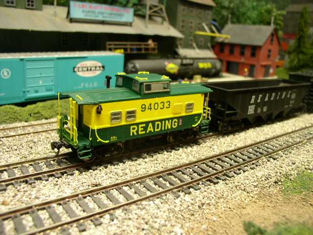

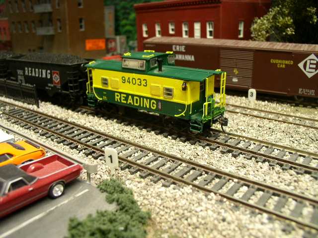

OK... here's to another finished project....
I used lite mineral spirits to try to dissolve the backing - didn't dissolve, but loosened them up enough to gently pry them off. However, there was a clear film still on them that I had to kinda scrape off. I also painted the end hand rails to match pictures in the freight car book. Interesting that this caboose is only one number off of the one in the picture in the book. Also added end lanterns and ACI labels.
