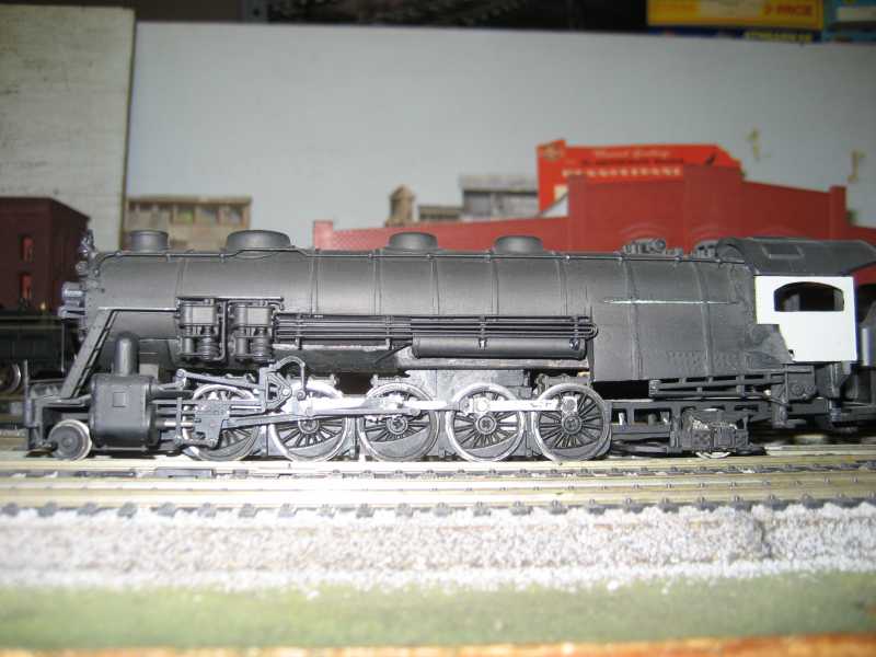

I finally found the photos of my damaged K-1 after a real fire when a candle left burning on my TV top started the tender (an old AHM berkshire tender) on fire and burned the cab. I was attempting to rebuild the cab but I put it on hold to look for a better drive train. If you notice a lot of brass details were used. I lengthend the boiler. I removed the sand dome air pumps and other details. Then I filled the holes with plastic and green squadrand putty, sanded and added the details and straps. relocated walkways, air tanks & pumps, piping out of bent brass wire, new bigger stack and longer brass ladders, and more. The rear underframe was scratch built and a modified brass trail truck was added. The last set of drivers was attached to the bachman frame cutting the first plastic lower frame between 2nd & third driver and the second between the 1st & 2nd driver then lapped over the old cast metal split frame to support it. The main drive rod was lenthened by soldering two together then fileing the solder till it looked good. What was I thinking!! Even though I measured the distances between holes and drilled them at the right distance. Still occasionally the wheels would bind. Thus the standstill. So it sits in the round house.
Daniel J Mohr
Reading Company kitbash corner 13 years 7 months ago #440
It looks nice!!!Are you thinking Bachmann USRA 2-10-2 for a decent mech??? Might have to worry about valve gear/crosshead issues.. but overall.. compared to finding (and affording) an old NJ Custom Brass K-1...Now use that theory and apply to a modernized N-1!!!! (I'll cheer anyone who wants to tackle it. If Casey hasn't tried, maybe someone else can?)
