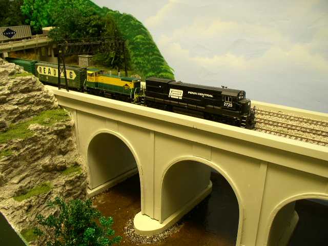

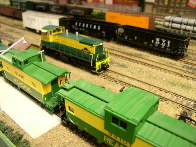

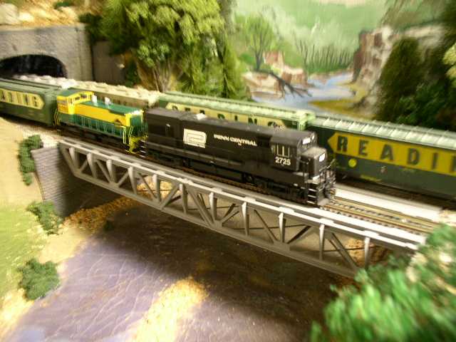

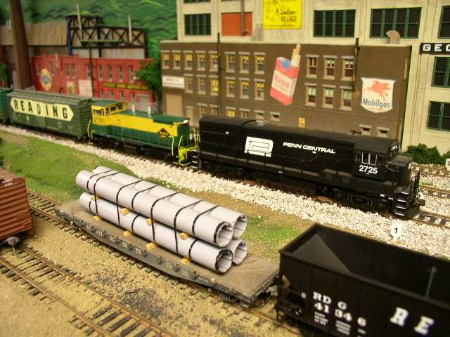

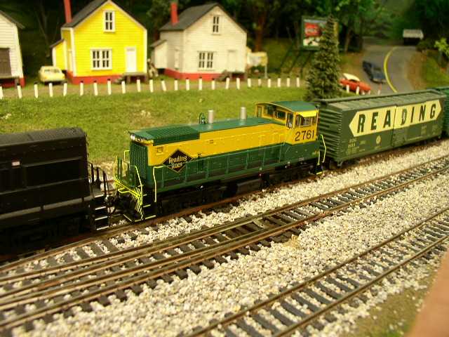

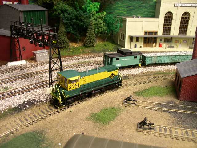

Yes... the stacks are silver/gray. Guess I'll have to fix some of the items mentioned here. I wondered about the shades... have never seen a Reading unit with shades!
Picked up mine tonight. Joe, a friend of mine, got these for us at a nice price. Modeltrainstuff.com has these for $180.
Here's mine being delivered via PC run through....
