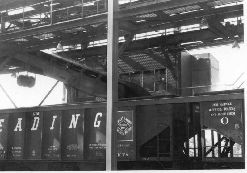

Athearn HTw Hoppers 11 years 9 months ago #4146
None of the HTw cars in Ore Service actually had orange end panels. This was limited to the HTz cars.
Athearn HTw Hoppers 11 years 9 months ago #4147
Nice photo..... under the loader at Grace Mine no less. Notice the GM in the top center of the car on the left, for Grace Mine and I assume the O in the end panel of the right car stood for Ore since the verbiage just says "For service between Joanna and Bethlehem"
