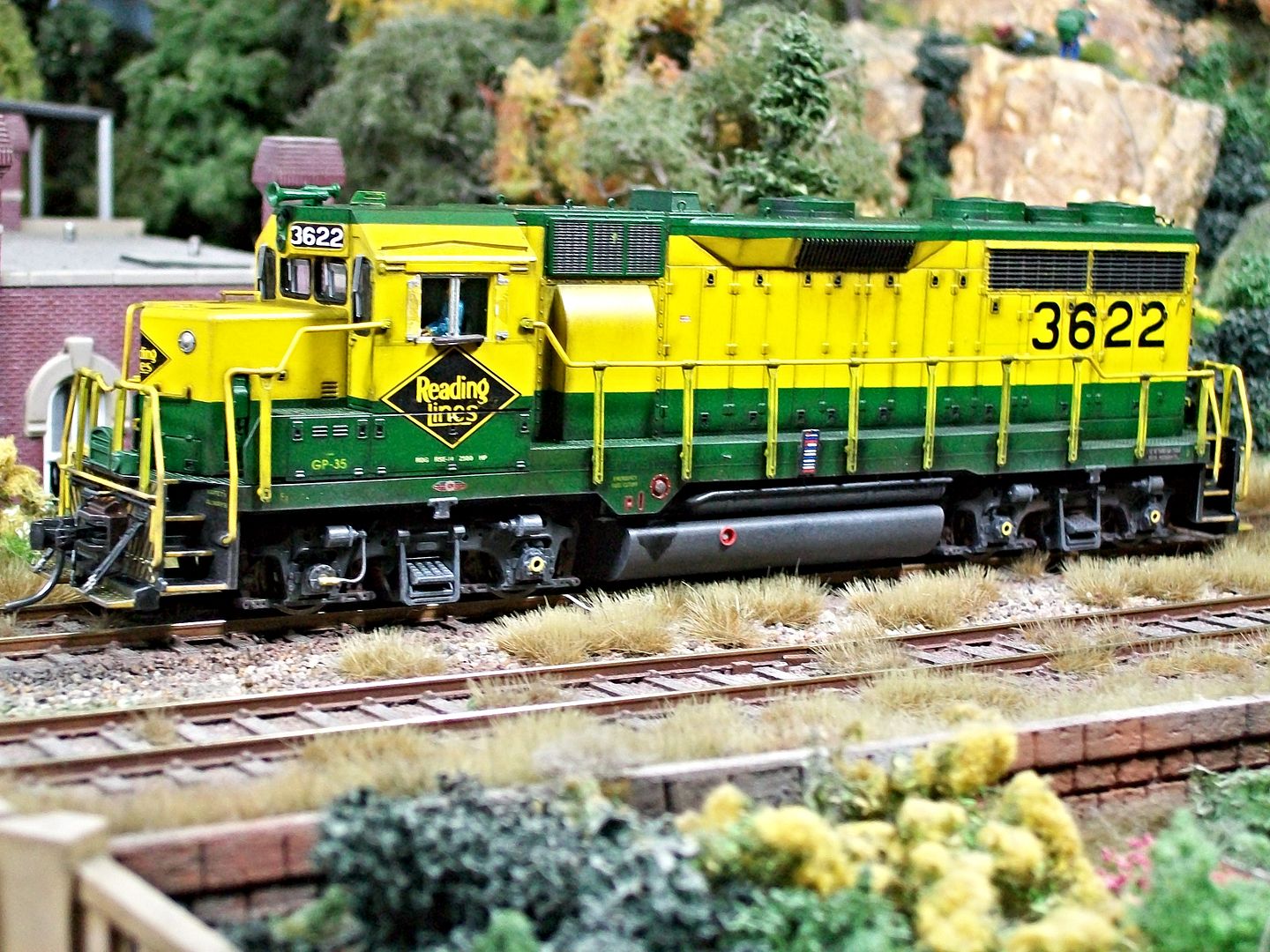

RDG 3622 completed
List of materials
Kato 35 1a undecorated
SCII RDG green and yellow,PS,Floquil and Testors paint also used
CalScale drip strips(cut to fit)and sinclare antenna
MS decals
DW speed recorder
DA mu hoses,arm rests and wind deflectors
TCS 121 sound decoder and AK-MB1 motherboard
TDS super sonic mini speaker and enclosure
Miniatronics 2mm tower LED's
Weathering pan pastels sealed with dull coat
Engineer's side
3622 teamed with 629
