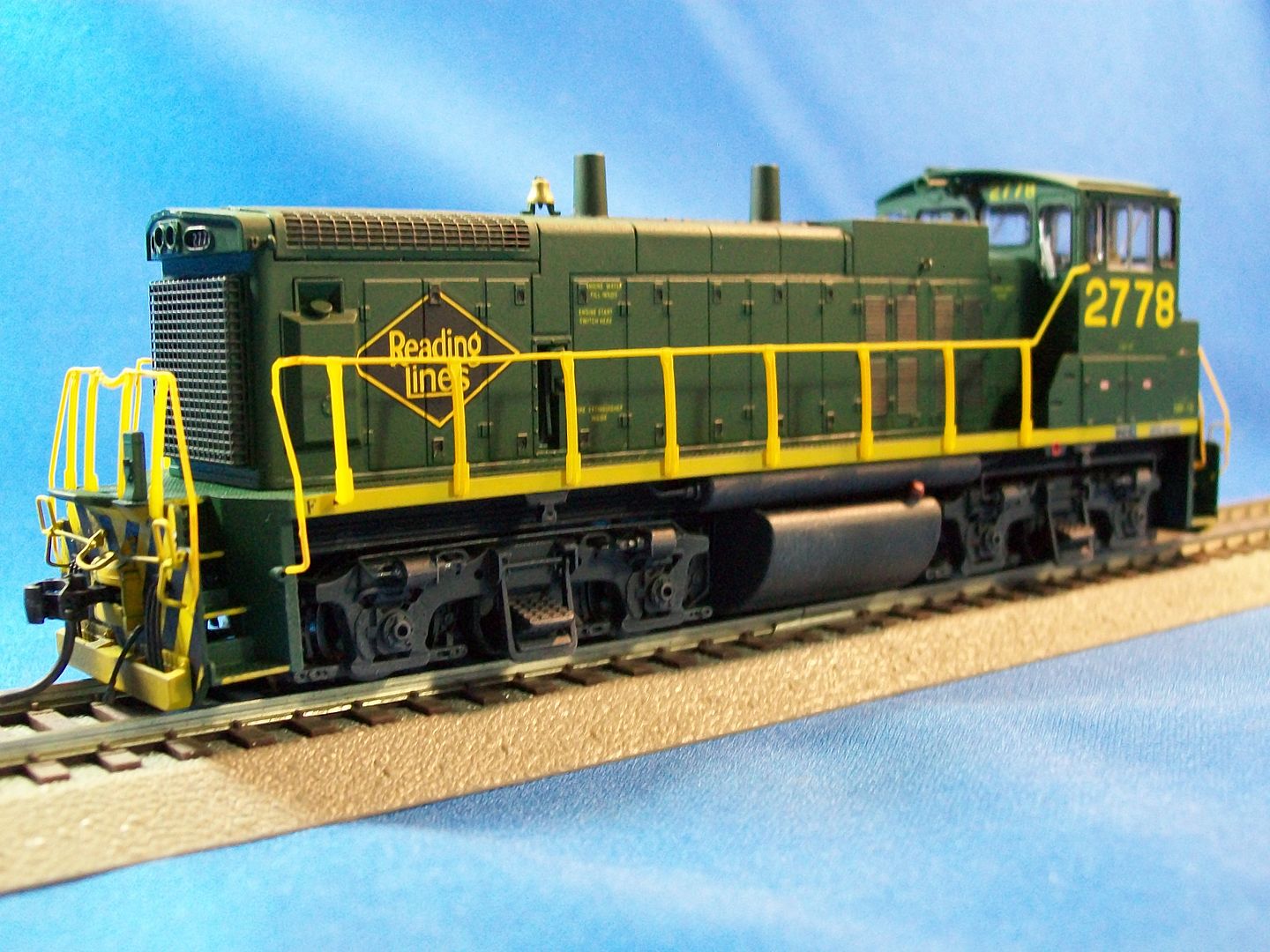

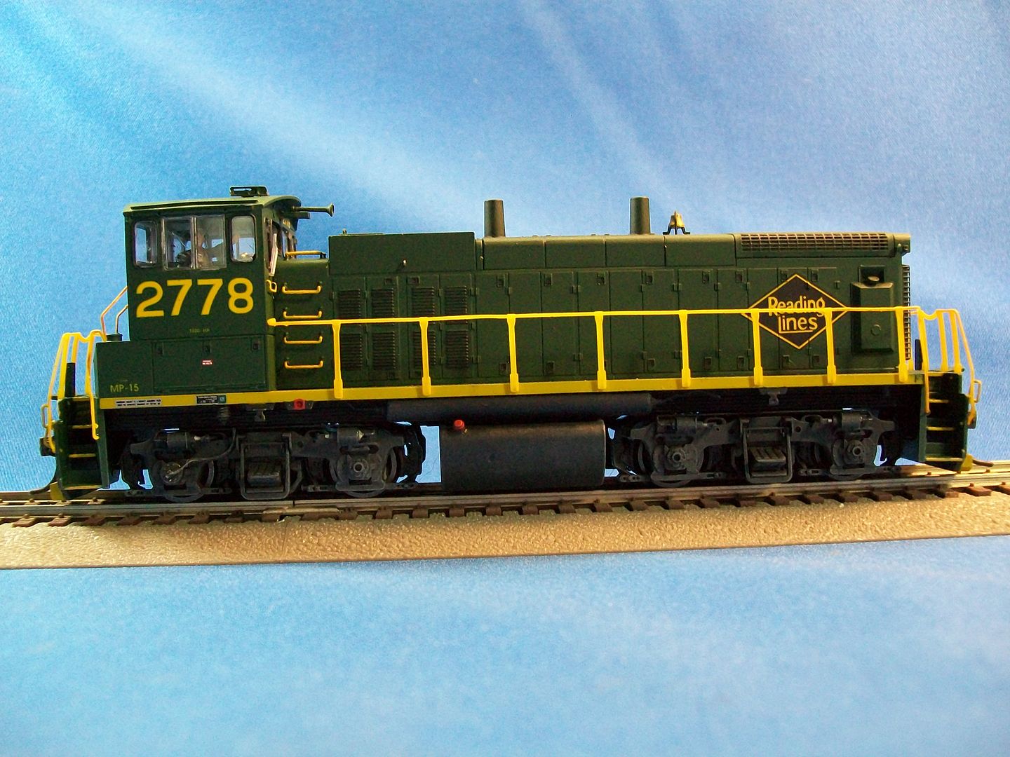

Added two more MP15's to the roster.

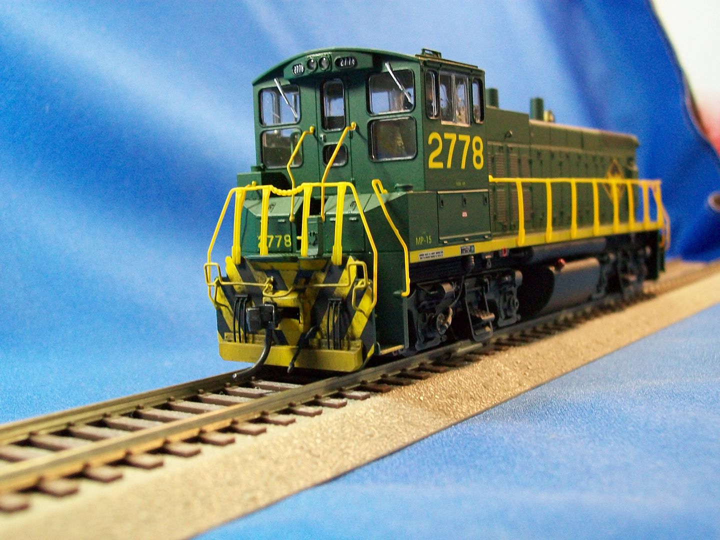

First up views of 2778
Side two

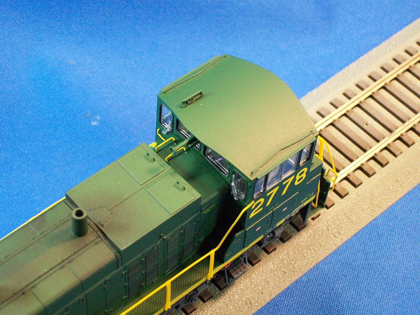

Roof shot single bell horn, drip strips Sinclair antenna

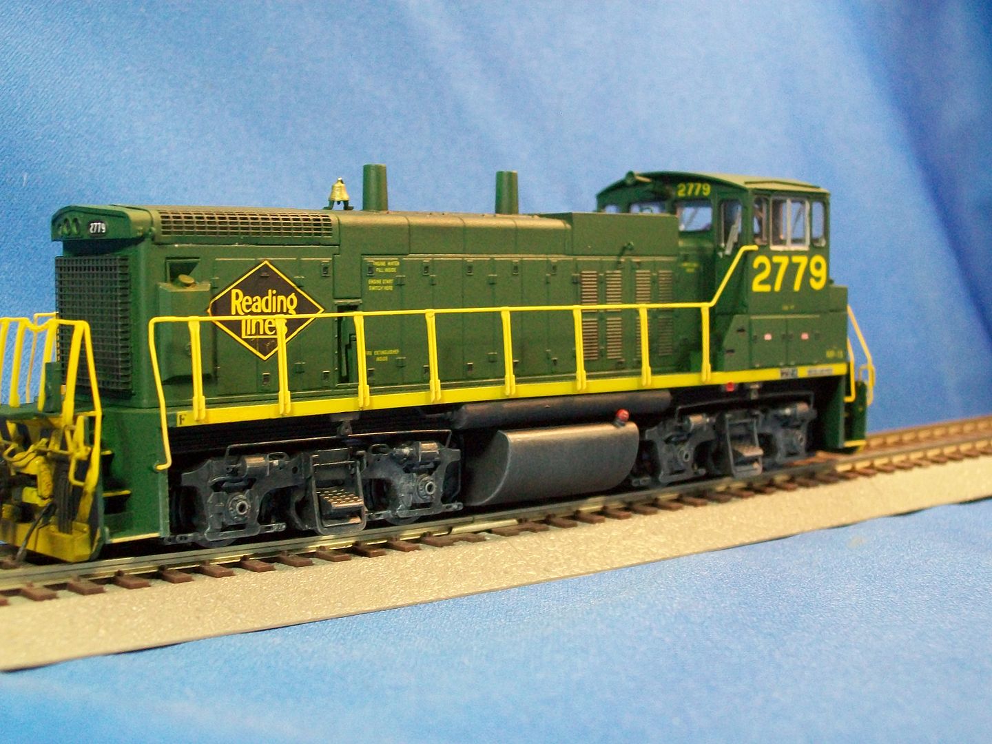

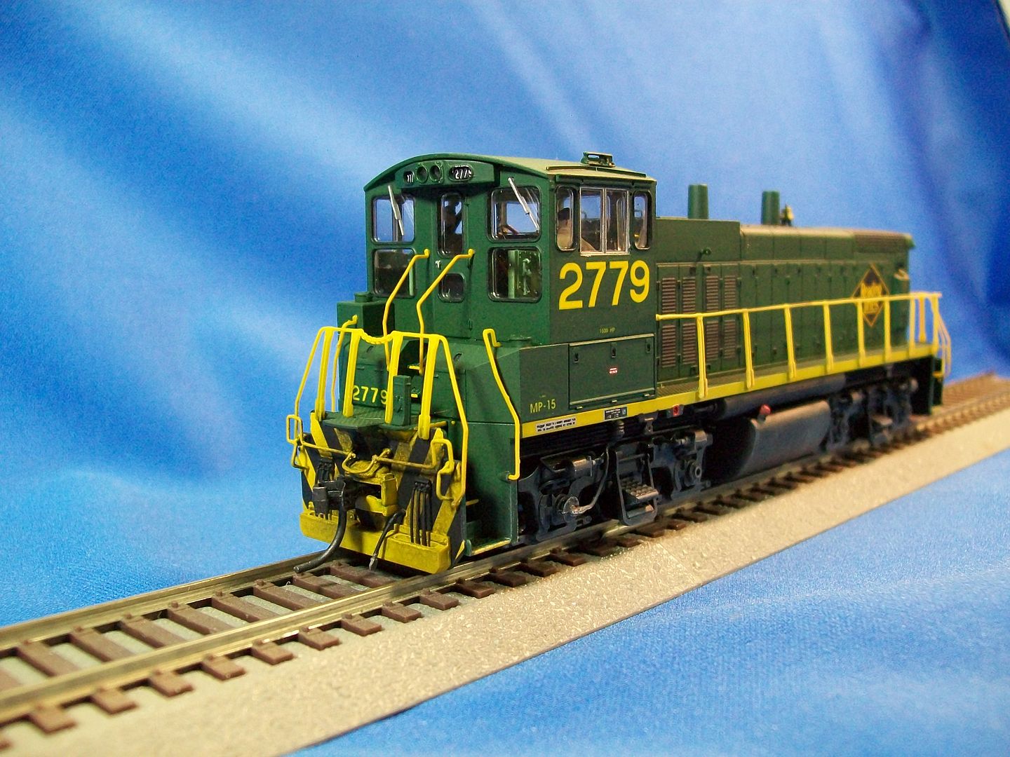

2779 Side one
Side two

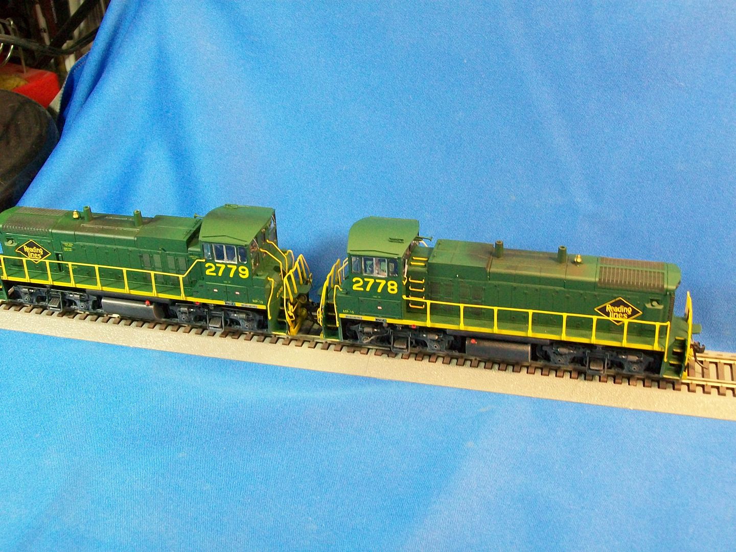

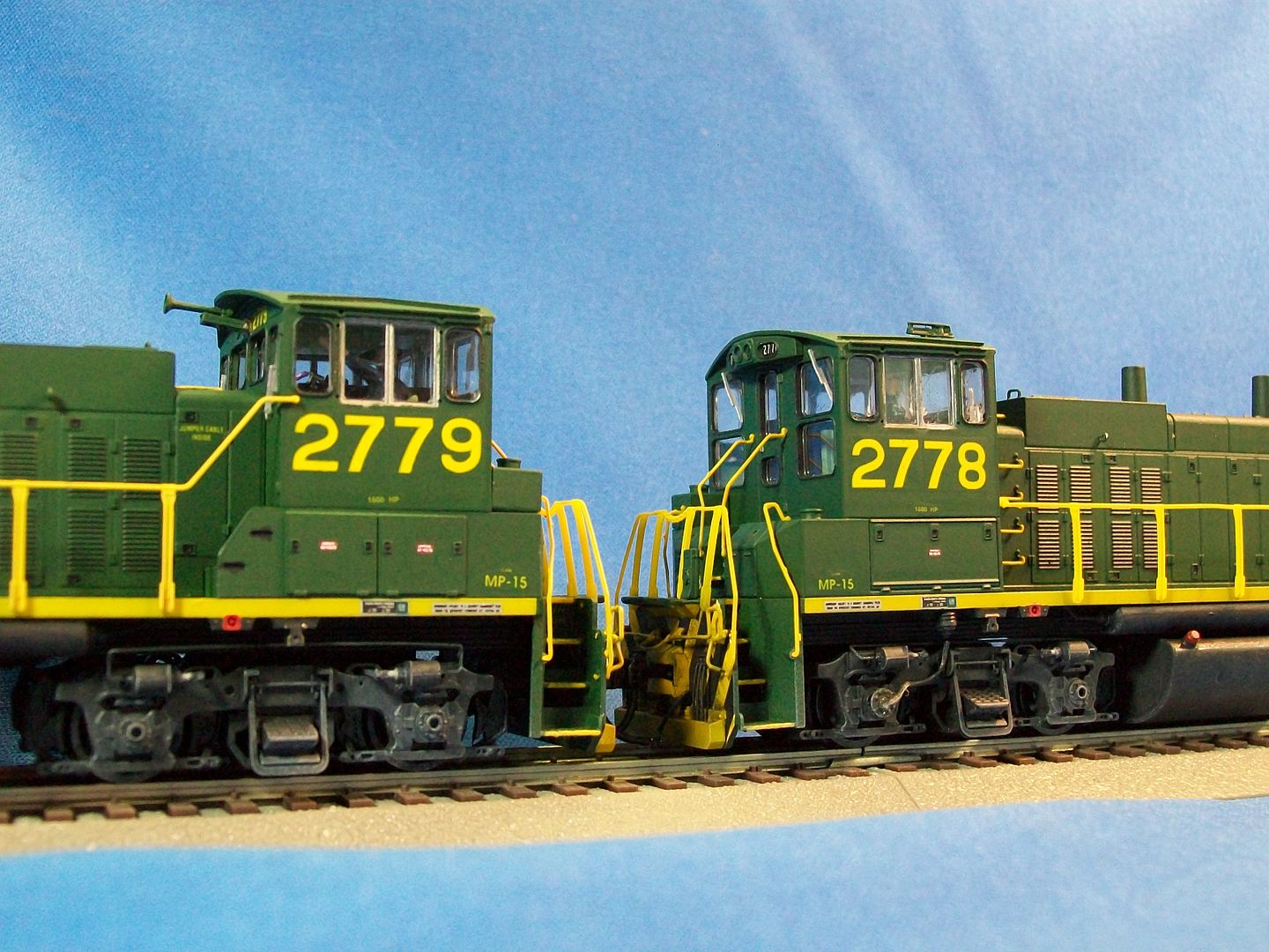

2778/79 MU'ed

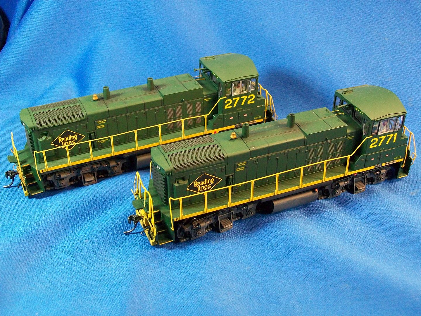

My up to date roster of MP15's
2771/72

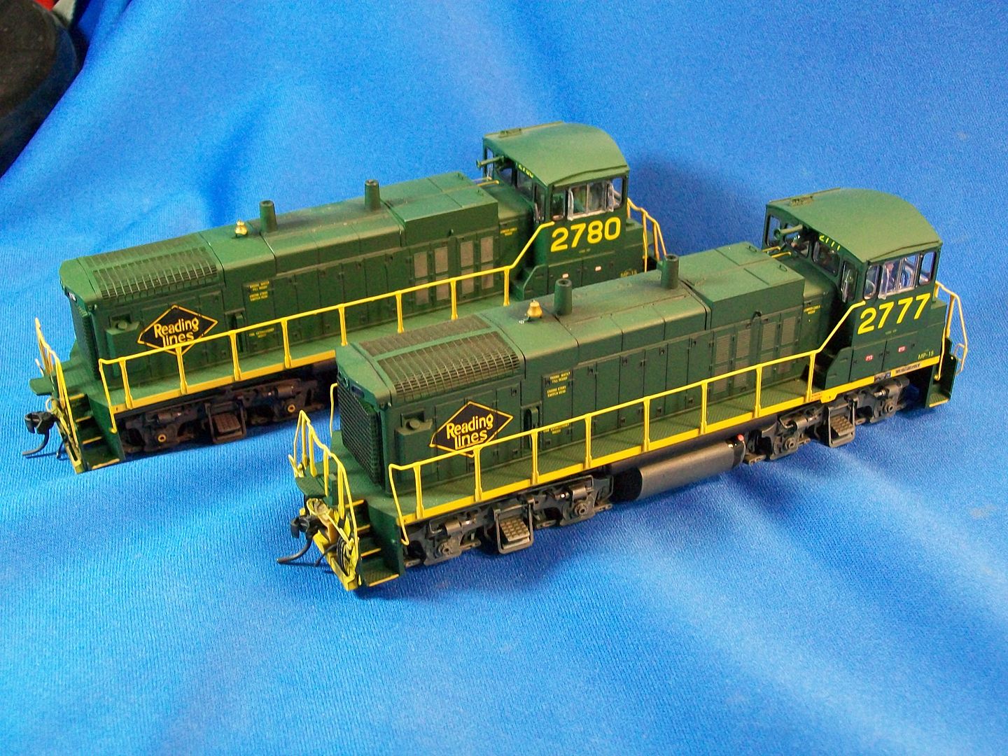

2777/80

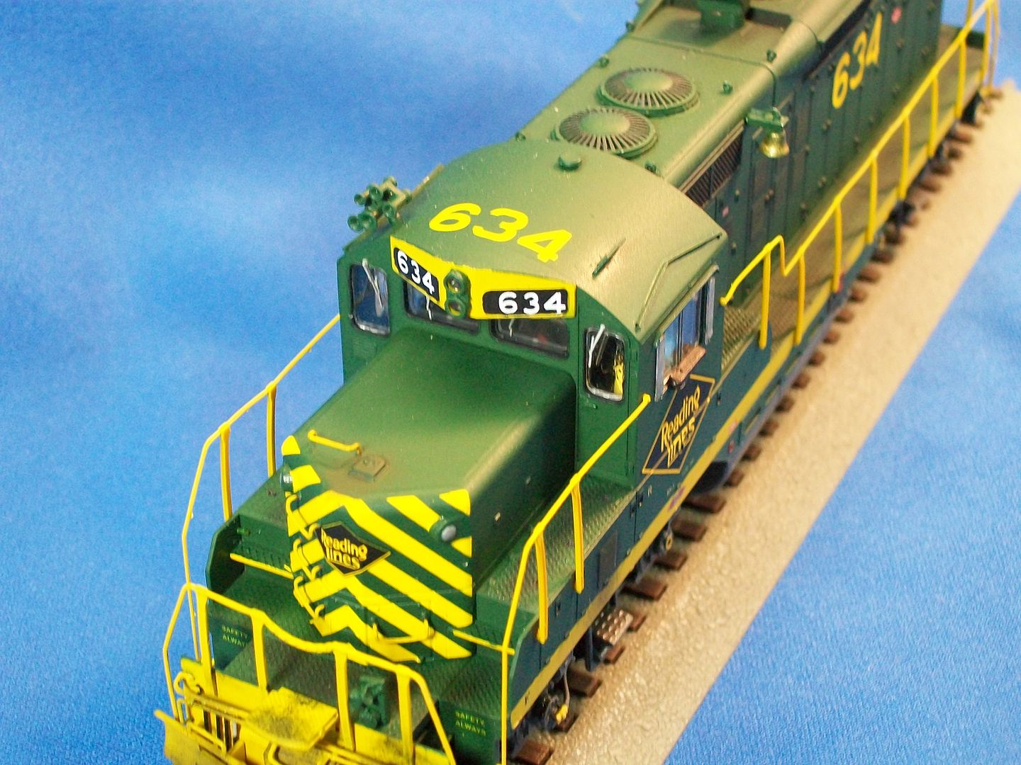

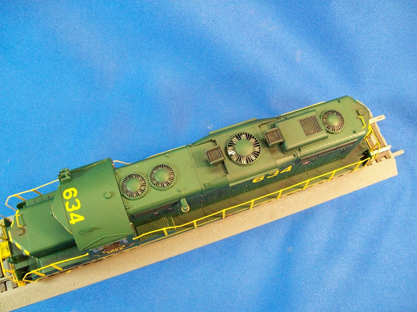

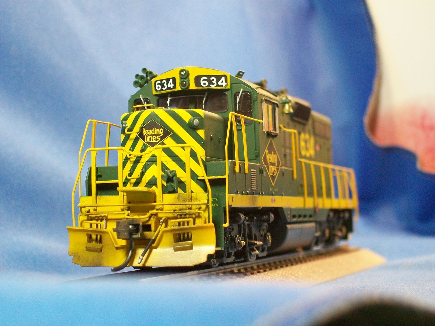

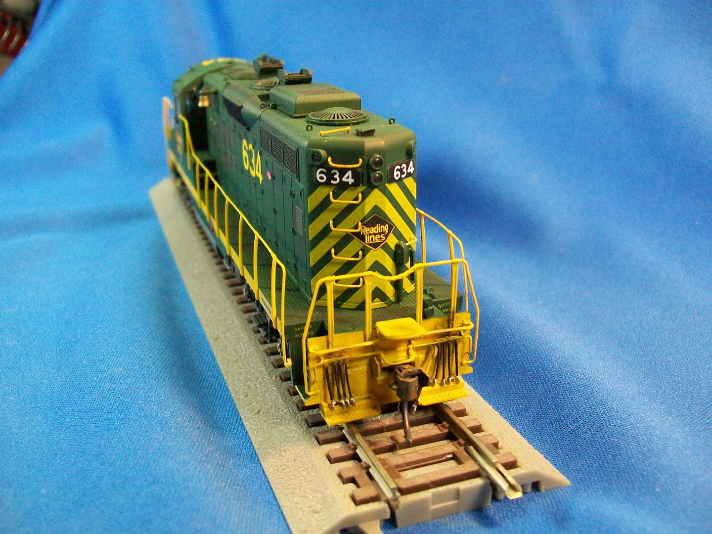

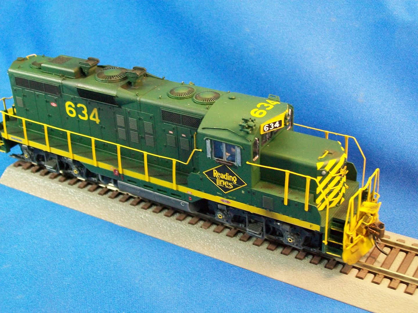

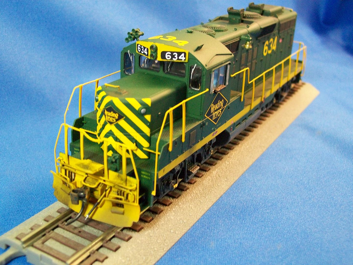

Every once in awhile I decide to model an alternate history model so when Walther's released their low nose GP9 the wheels started turning I decided on GP7 #634. Now 634 received damage from a collision with a haulpak in late 75 and with conrail a few months away its fate was up in the air. Conrail sent 634 to Paducah for rebuilding but on my RDG RR Conrail failed to arrive and the RDG sent the 634 to Paducah.
Hope you like the results...many detail parts used but in my search for the oxbow air filter came up with a big zero...if I find one I'll add it later.
My 634 side one views

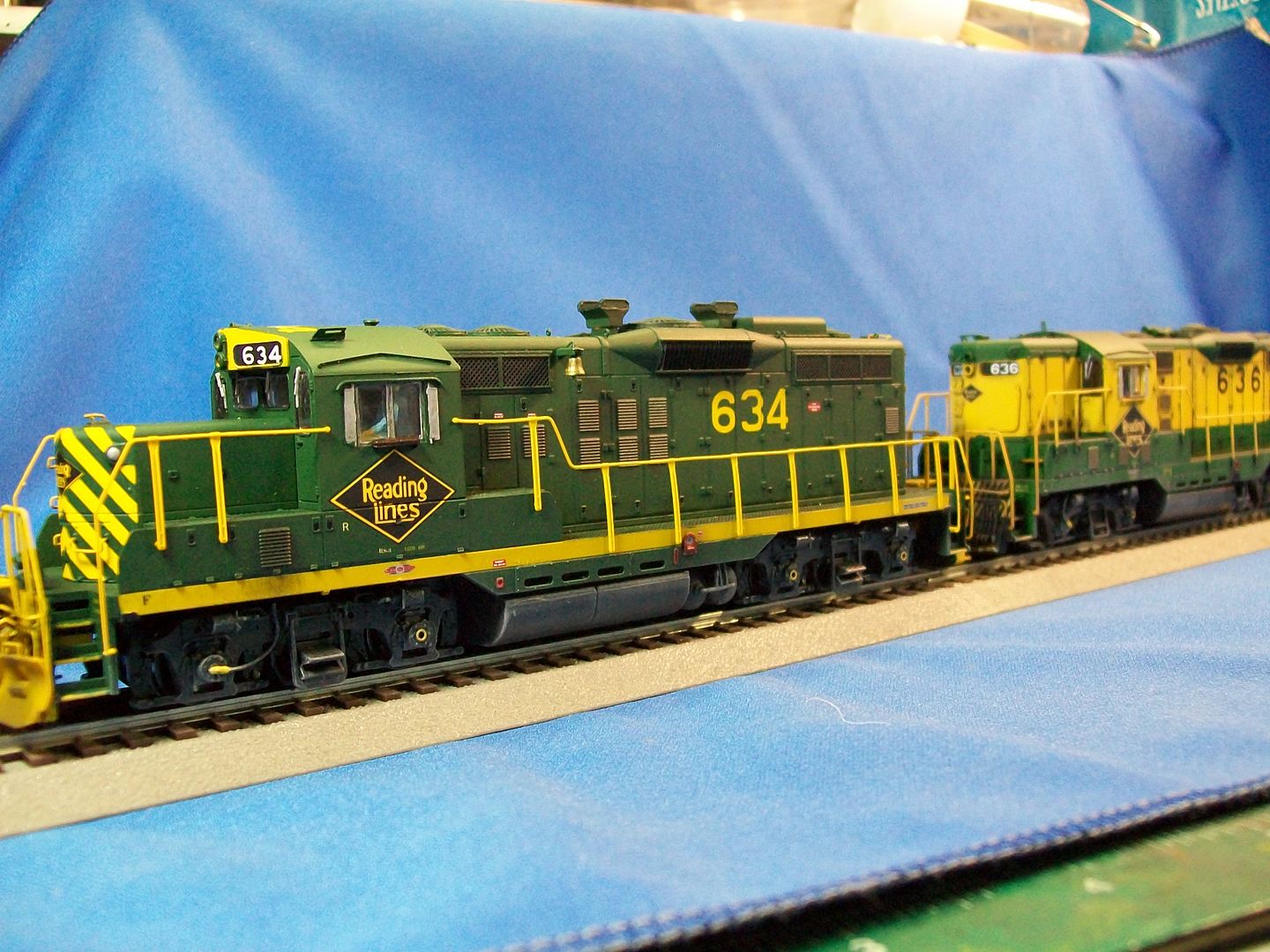

634 side two
The unit was painted using SCII paints and weathered lightly. Microscale decals... Note Microscale has now restocked the RDG barricade stripes 87-708. I installed the TCS Kat3 wow kit and the TDS super sonic speaker

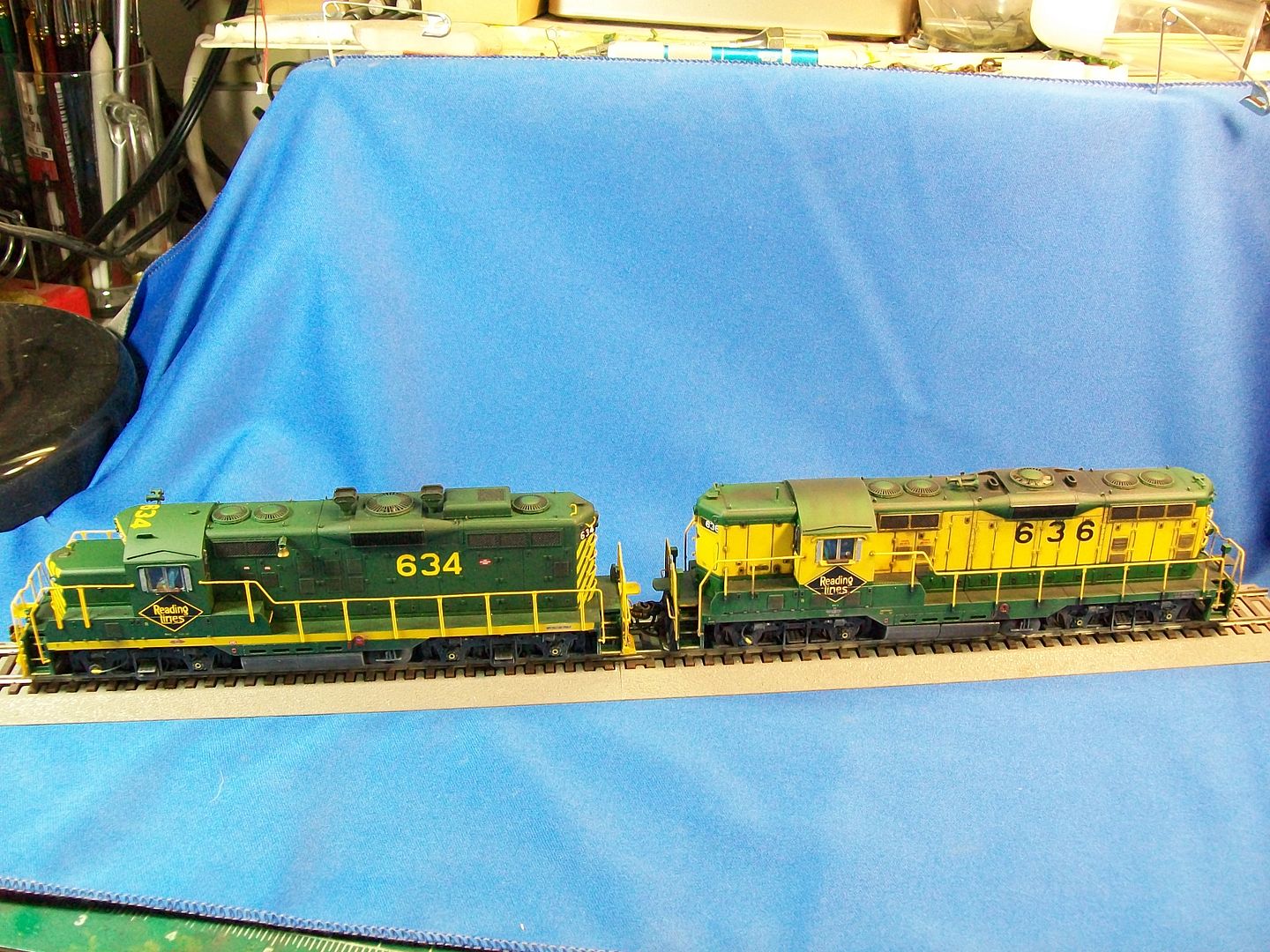

634 teams up 636 on the Mine Hill
Thanks for looking
Paducah!!! Was able to find the horst air intake and added the part to my alternate history 634
