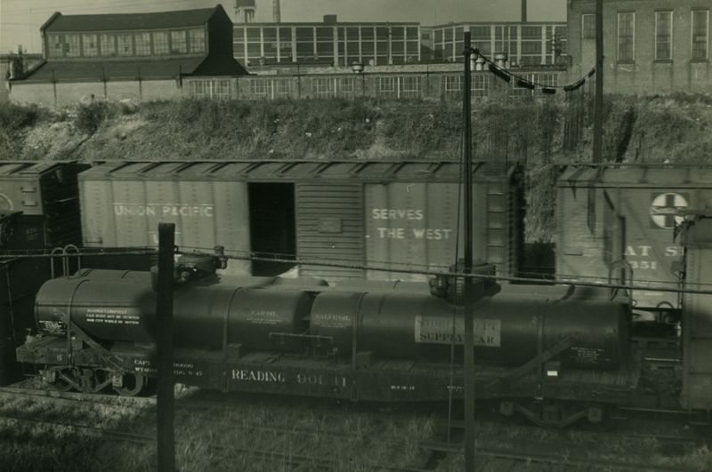

This may not be the right number. I couldn't find it in the M-O-W listing. Any info, especially about tank and tank dome diameter. Suggestions for modeling? Another eBay photo.
Francis A. Pehowic, Jr.
What a gem! also in for info. it looks like it was taken in the 50s, and the car was obviously modified specifically for those tanks...Any inputs Mr. Hall?

Car No. 90941 is listed in the MOW pdf as TMd 90941 Tank Car, converted 7- 2-23 from GAb 23274, 36" dome. No retirement date is listed, but some TMd tank cars lasted into the 70s.
Something doesn't seem right. The tank care in the picture has 4 domes. They don't look to be 36". Maybe it was modified at one point.
