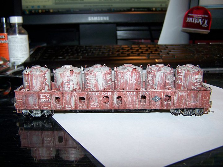

Here's my version of the LV cement gondola with air-activated containers - based on the Jim Hertzog MR article that started this whole thread. This car was my very first kitbashing project in the hobby, built shortly after the article came out.
cement container gondolas 13 years 3 months ago #1539
Nice work! looks like the contractors got a little sloppy with the concrete!
