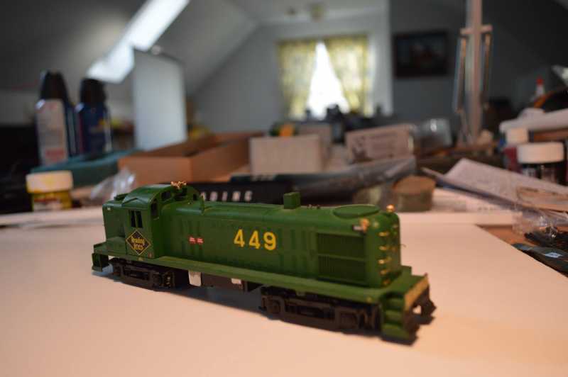

What did YOU do this week? 11 years 11 months ago #3779
RDG 449 in progress
