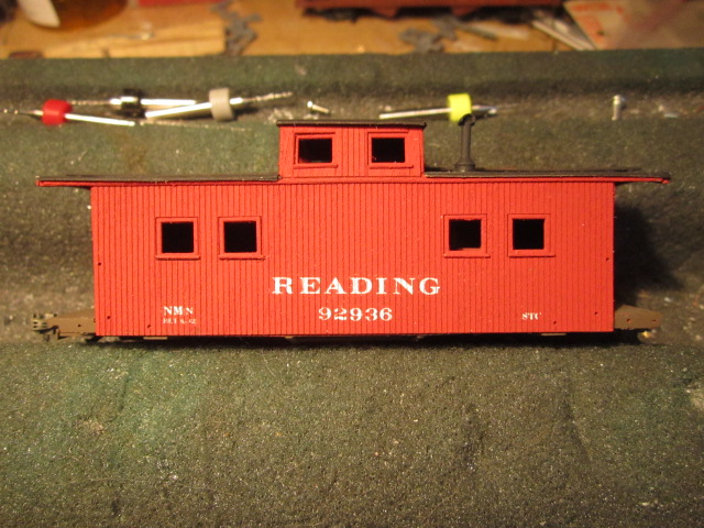

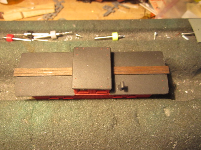

As we continue to discuss the topic, Butch mentioned the laser cut wood kits. They went to Shortline Products, and they are alive and well in production. There is a web site, and are listed under the kits section, product no. SP-25 for the Reading. Here are a few pics of mine in "slow" progress, and this was a donated prize from Shortline at the first Modelers Meet. If anyone is interested in a core or two for these conversions, I have a couple sets to spare. I purchased a "lot" of projects that someone started as LV conversions.
