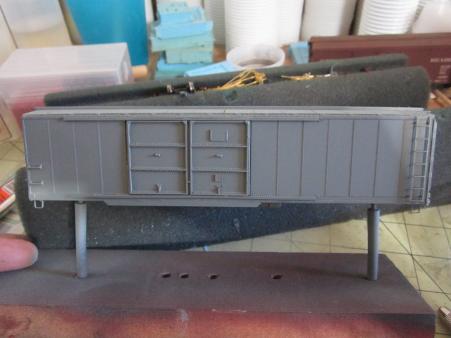

Before anyone puts the wagon before the horse, the Red Caboose X-29 interior height would best represent the XMt class box although totally different side panel count. The XMu, was a 9'3" inside height that of a 1932 ARA standard box, and the XMv was sort of a hybrid 1937 AAR box with '32 characteristics. Now, F&C has recently released the XMv and XAe. These Creco doors were slightly different in height than the XAd, XARa. It would be best to get a general idea of what HO scale boxcar one would utilize, i.e. a square corner post 1937 AAR box by Red Caboose and scale from there. I did a pattern for the double door to replicate an XAg, on a Life-Like Proto 2000 50' end door box, a fellow "modeler" from the site has a set of these, and if anyone is interested in these I can make them as needed. It's just some food for thought, in going forward with the idea, and Turbo, there just happens to be a few existing XMv's close to my residence should you need any super detail photos for reference.

I doors I have the design for are for the 8' wide standard boxcar, not the XMu or XMt. I am fortunate enough that Micro-Trains makes the CRECO in N scale for those boxcars. Also looking at your HO cars, I realize they may have more detail that my design, which might exceed my current skill set at 3D design. I will have to look into it, but the close-ups will absolutely help. In N scale, the details aren't as necessary as with HO. But I can try to work them if there is a market for them.

  • RDG1519
  • RDG1519's Avatar
  • Posts: 56
Bill,
Those doors in the photo are 6 foot doors?
They look great.
Chris
Chris
