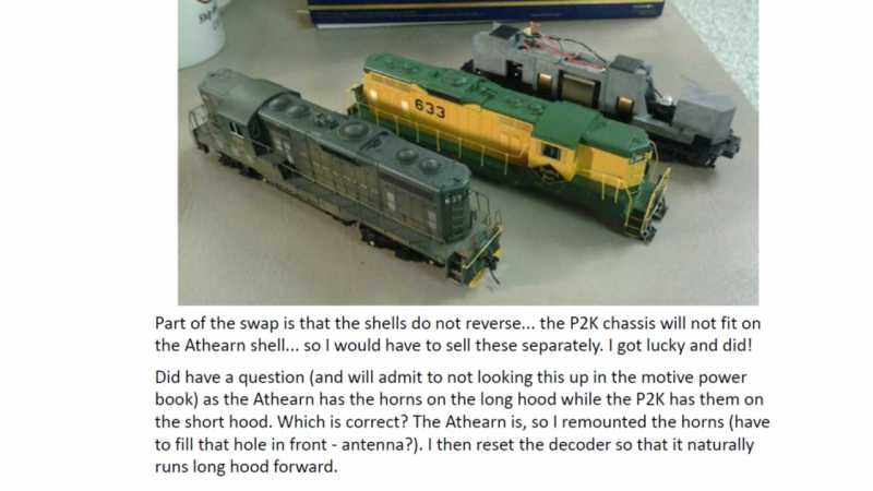

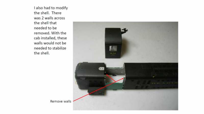

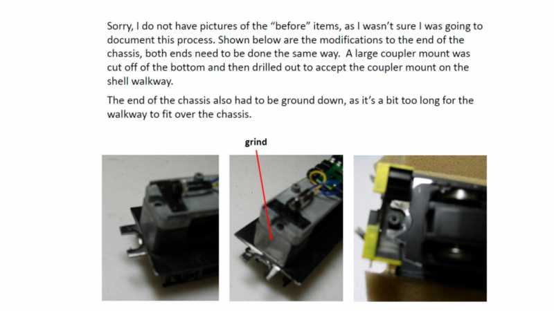

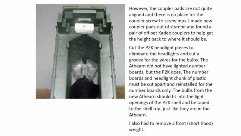

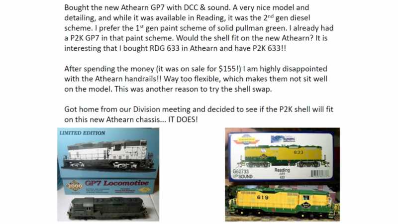

Hello...

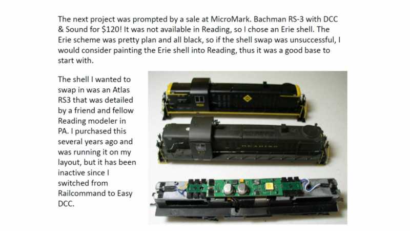

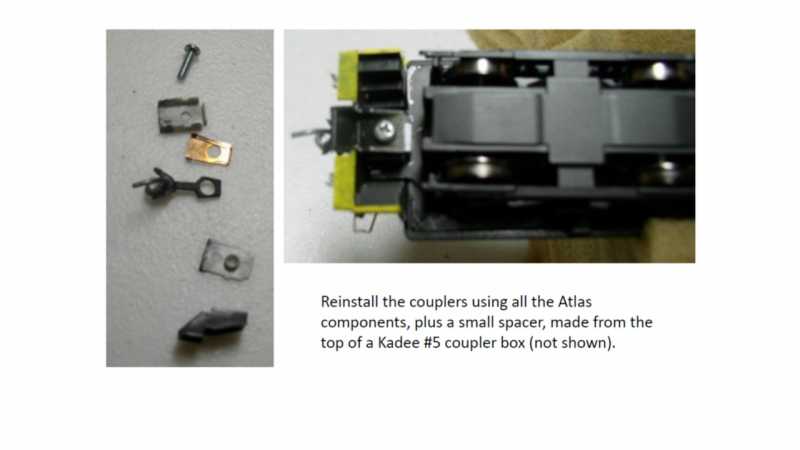

I believe it was mentioned in another post or 2, that I have recently done a few shell swaps on some diesel locos. Here is the powerpoint file (in PDF format) on what I have done so far.
Last Edit: 11 years 10 months ago by rdg-barry.
Shell swapping! 11 years 10 months ago #3529
hmmm... file didn't attach... here's jpegs of the file....
