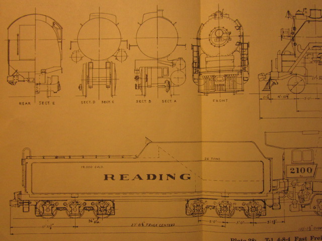

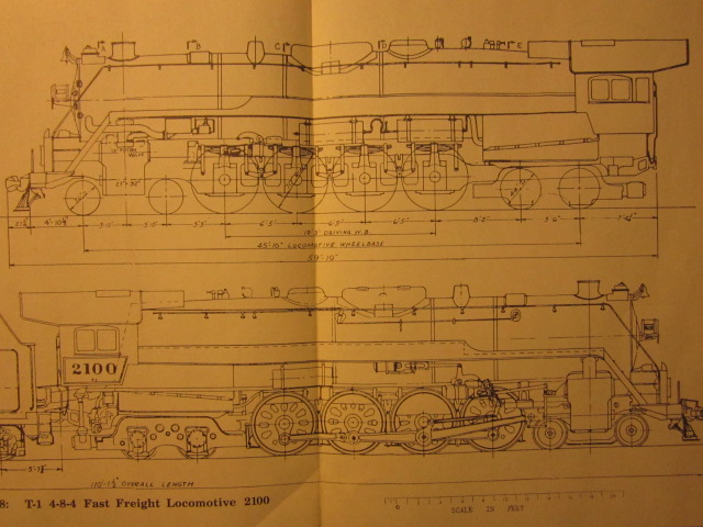

Turbo, here are two pics of a print I have in my collection. I don't know who ever produced them, the scale doesn't even match anything on an old school architect rule! Anyway it may be of help with the cross section profile of the firebox.
Reading T-1 in N 11 years 7 months ago #3953
Bill, these were drawn by Ed Wiswesser. And I believe they are O scale . They used to be available from RSME . Butch
Reading T-1 in N 11 years 7 months ago #3955
The drawings may still be available.
See this thread for a discussion about the drawings and their availability:
www.readingmodeler.com/index.php/forum/t...nd-car-dwgs-the-list
Read Riggleweg's first posting on the thread for information about ordering as well as a link to the listing of all the available drawings. The listing includes an address that worked in March 2013. Specifically, to order "T-1 4-8-4 Frt.&Railramble 2100's," ask for drawing # 31 on the list of separately-available ones. It is 1:48 (O Scale). I received my order of drawings within 10 days of placing it by US Mail (YMMV).
Riggleweg's later posting on the same thread listed the drawing that came with the book Steam Locomotives of the Reading and P&R Railroads as #28 out of the 30 in the book. Do not use #28 - unless you want the F.M. 2400 hp Trainmaster :).
George Nelson
