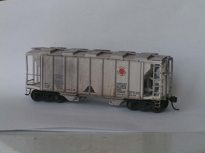

Well, it's done after 10 years or so, taking a Bowser ACF hopper and converting it to the older style 10-hatch version. Back in the 80's, when E&B (later Eastern Car Works) came out with what was then a state-of-the-art kit, Todd Sullivan did a great article on modifying them in RMC. I took the Bowser car, did the offset-dogleg angle to the side sills by the ladders,added new stirrup steps, filled in most of the side opening triangle, and added hatches, using Detail Associates hatches. I used an old Champ LNE covered hopper set, and weathered with dry brush and chalks...

Nice work Mitch! Those dog-legged end sills must have been tricky modifications. Did you
Carve those out of the existing casting, or are they replaced pieces?

Better late then never Mitch...the model looks really good...like the weathering.

thanks-only took 6 years, unlike a lot of you guys that seem to hatch 10 cars or locos a week! Yikes-you make it tough on us part-time modelers! yes, the ends of the side sills were carefully carved out with an X-acto and a cut down sanding stick, eyeballed to size against the drawing in the article.(I want to add hand-carved, the old fashioned way, by skilled artisans sealed up in caves overseas... but I won't)Thanks for the complements.. I should have another car or two done in time for my retirement party...
