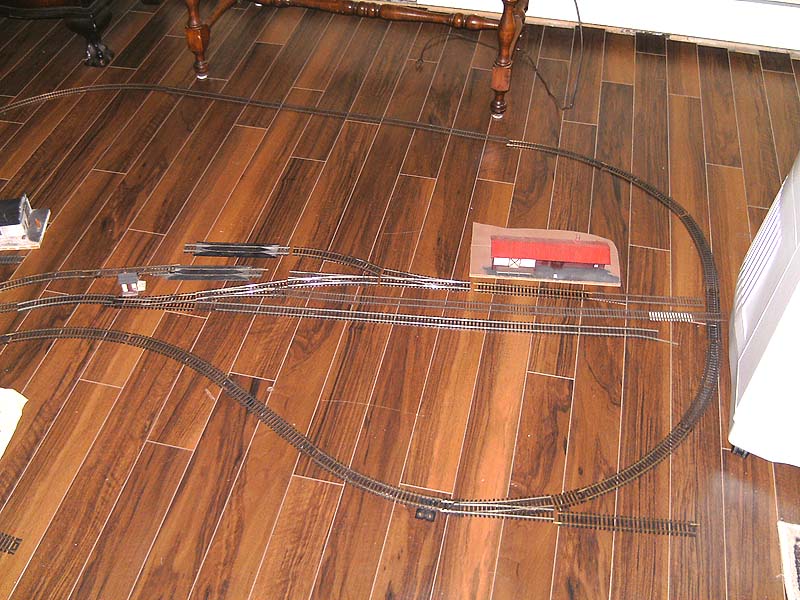

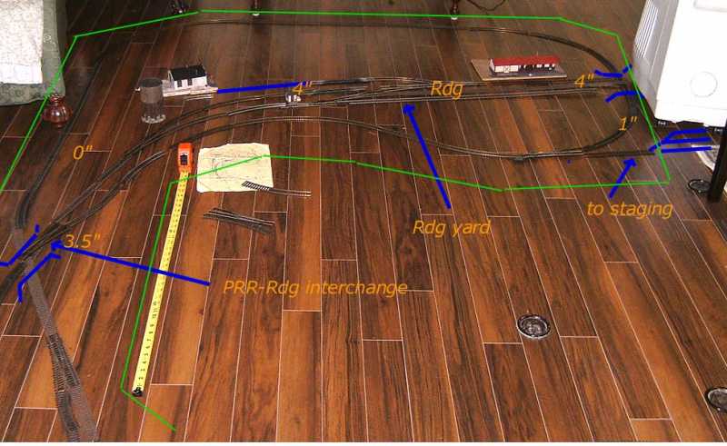

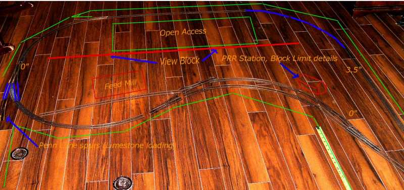

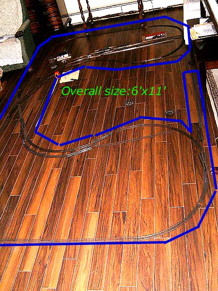

Layout "mockup".. at last! 11 years 6 months ago #4144
I've been off this week, so I took the opportunity to make a rough mockup of a proposed 6x11 layout I am fixin' to build in my train room. Our living room is big, so up it went! The odd dimensions are due to it's being an old boy's bedroom, in a finished part of our basement, with closet space tucked under the stairway. But.. without any assistance it never goes below 55 in the winter or 75 in the summer, and has a drop ceiling and carpeting. SO even though it's not dream-layout sized, it's the perfect place to build a nice little Rdg-based branchline operation. It's roughed in with snaptrack so it's a little more "symmetrical " than it will be in real life. Curves will actually be 20 to 24" radius, 18" snaptrack it was I had on hand from a hundred years ago for the mock-up. All switches are Peco Code 75 short radius electrofrogs, track is code 83 flex...loosely based on a PRR (or PC) and Rdg branchline interaction that did take place in a few Rdg locations, but totally protofreelanced, period 1966-76.. staging will be a little 12"x30" sliding yard using drawer slides and a doorlatch arrangement. I am converting stuff to NCE DCC...I don't remember who posted them but one of you folks did a snap-track mockup a while ago on a W&N themed branch??? The 2 lobes are 6' long by 42" with a 3' stretch that will be over my workbench, and a quarry branch opposite that, on a 8" by 30" shelf...I know I'm being a bit longwinded for a little layout but it's my first "real" one at the tender age of 59..
