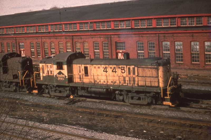

Well,Athearn can keep them.Let's take a look.
First,these units were equipped with dynamic brakes,you know that feature will not be included.Why no manufacturer of the rs3 has produced a dynamic brake version is beyond me.
Second,another key feature is the extended battery boxes left side long hood forward.Many roads who operated rs3's had this feature.An important option that shouldn't be left out.
Third,why are the advertising 445&449 with lengthwise air cooled turbo exhaust stacks? These were changed to water cooled before they received g&y paint.
Fourth,494 paint scheme was applied differently around the cab as compared to the other two units.I can't see them doing that correctly.
The bottom line IMHO at 115.00 suggested price get it right or don't
do it at all.

Chris hit the high points, but let's hit a few more details. Pilot Detail is lacking, including railing and coupler area and footboards are missing MU hose boxes. Also, Athearn railings are incorrect
Now, modelers, I'm not implying that the Atlas unit is perfect, for any number of reasons including that the RS-3 exhaust stack is not tapered as on the Atlas model. I'm with Chris, I can't see spending $114.98 for a paint job that needs so many additional details. If you like the Athearn unit (which I do) you can buy a complete body kit from Athearn as a starting point.
As I'm doing a clinic on RS-3's for the Reading Modelers meet, I can't divulge everything.
