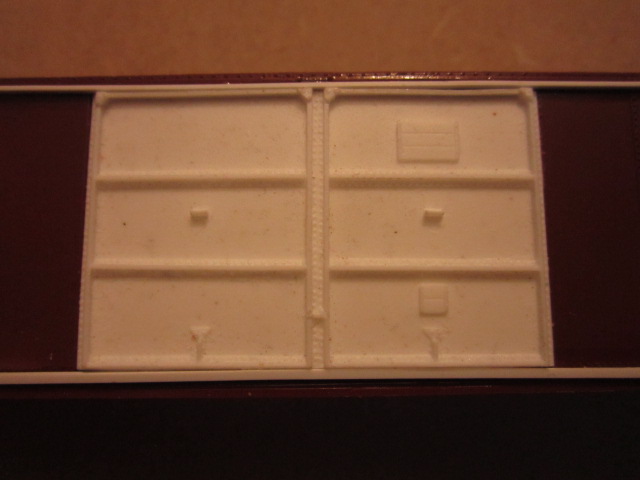

Next, as this topic started a while back, does anyone have a roof shot of these 50' cars after they came back to the Reading after refurbishing? When I started going through prints and paperwork I came up with a diagonal panel roof as the replacement and Apex A-1 running boards, whereas the Proto 2000 box had simply a raised panel roof. Also are the three panel doors 7' wide will have to be made. It seems like a fair amount of modifying will have to take place, but worth the effort. Bill.

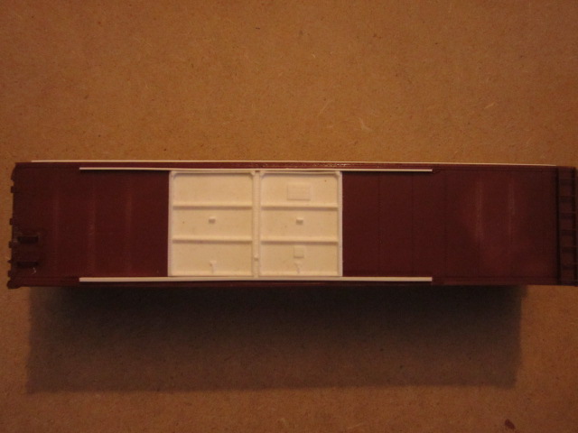

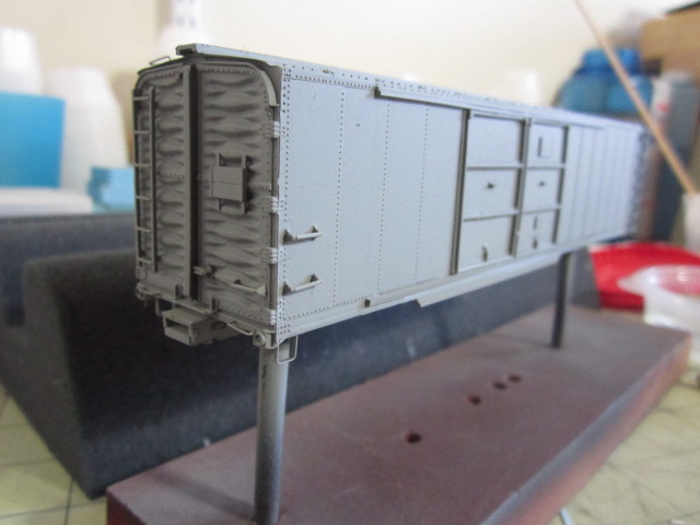

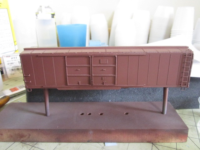

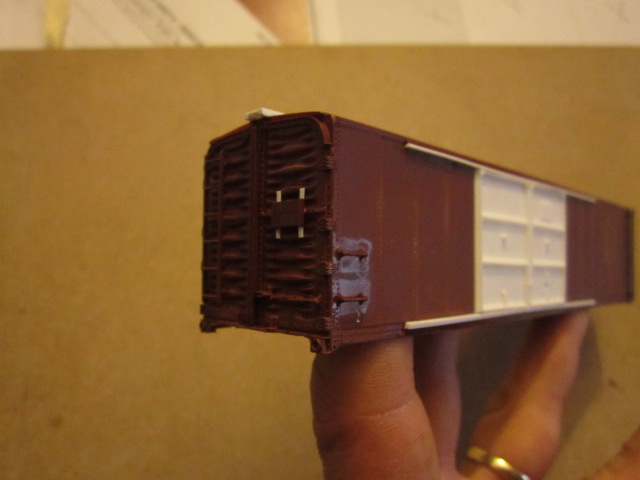

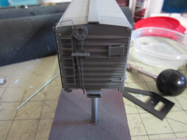

Finally have some time devoted to modeling, and doing so bringing this idea back. I worked on a resin master for a double Creco door to use on these boxcars. I'm going to use the flat steel roof for my era, and used the Detail Associates 4/5 Dreadnaught end opposite the auto end doors. Here it is to date, enjoy!

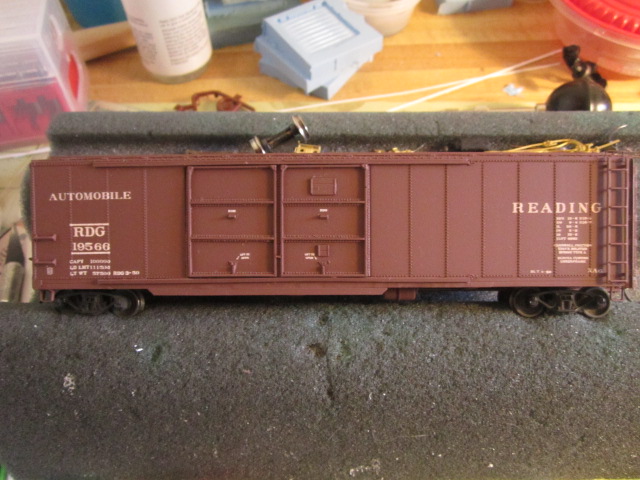

Here it is, the finished product! (Less, some subtle weathering chalks) I modeled it with the as built roof, consumed a lot of Micro-Mark rivets in the process. Now, having had the opportunity years back to climb up on an XMv roof, the panel spacing seemed to work out the same for the 50'car. I also used a variety of decal sets to accomplish the project, including those sold by the Reading Modeler, leftovers from the Funaro XAd, XARa kits, and some Diamond Scale Models.
