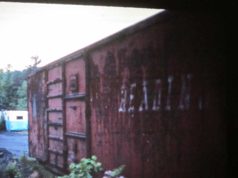

Here are some pictures of the hinged end door of the boxcars located at West Cressona Yard at the old roundhouse. XAg # 19583 and 19561.

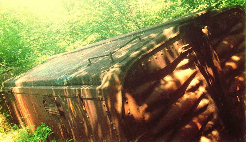

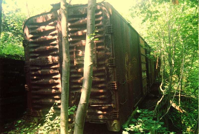

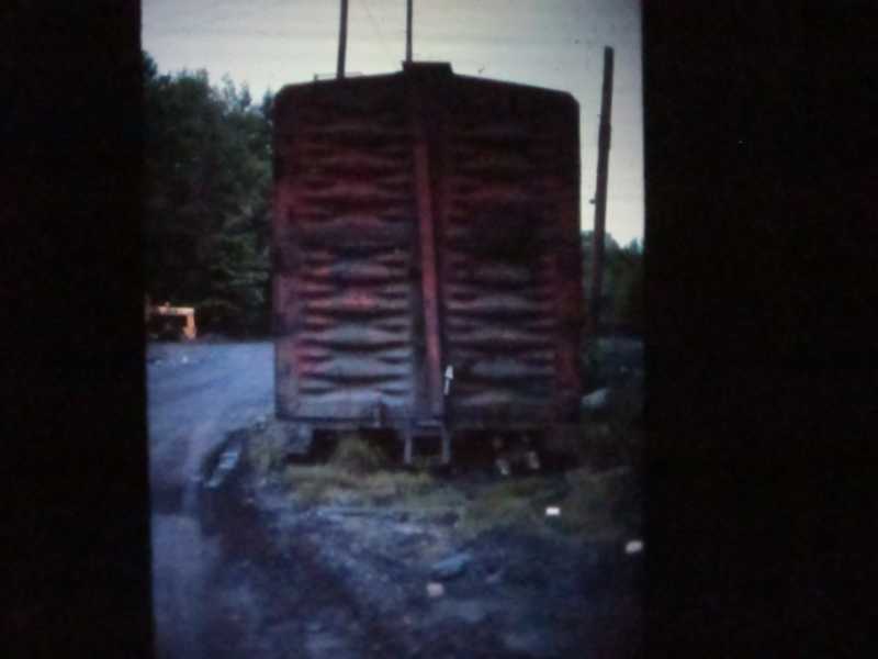

The second and third photo is of the hinged end door of an XAg at the Mahonoy Plane near Frackville, Pa. First photo is of the end door. (remind me to bring a chain saw and cut down that stupid tree). The last photo shows the same car and the roof. Note that the running boards are diamond tread plate mounted directly to the roof. It is not a raised roofwalk like on the P2000 car. But that can be easily replaced.
So I believe that the P200 car from Lifelike would be an excellant starting point for an XAg end door boxcar.

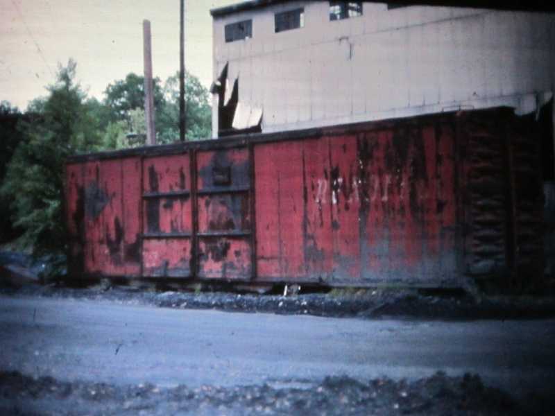

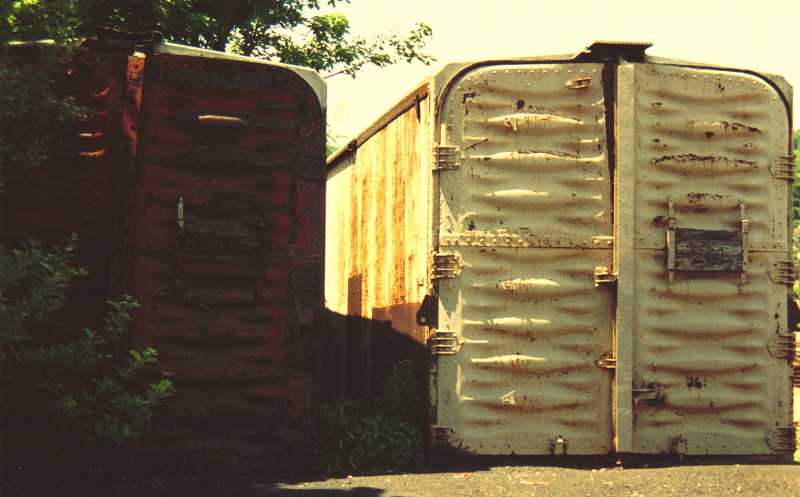

Here are some additional photos to help out, these were from a friends collection taken I think in the late 70's.
