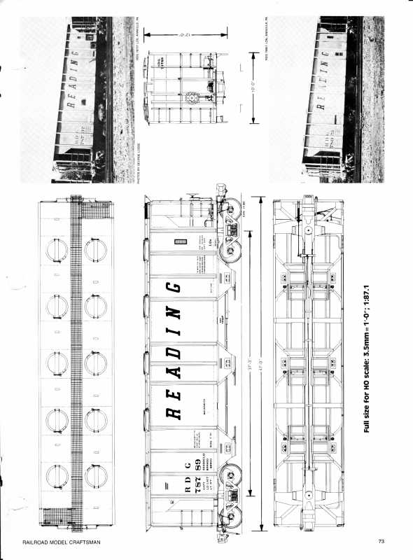

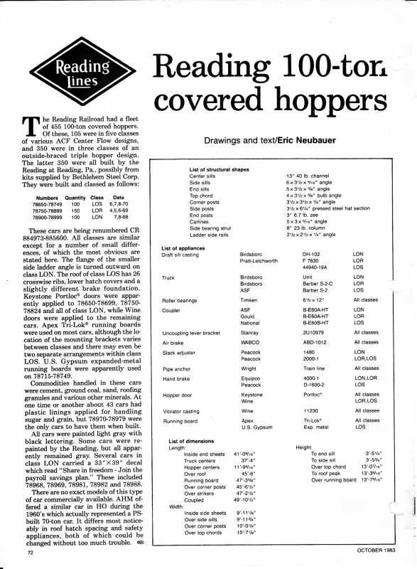

I’m sure I posted this to the forum before, but here is a copy of the RMC article on this car.
Last Edit: 11 years 11 months ago by MarkFJ.

As a follow up to Mark... Eric Neubauer also wrote an article with additional drawings and info for the Bee Line (probably Fall of 1983 or earlier... I think we actually printed our article before RMC) which included drawings on the LOs and LOr classes and loading charts for them.
