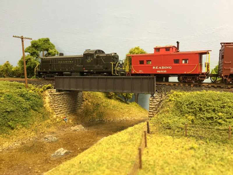

I finally got around to detailing a Bachmann caboose, and here is the result:
Thanks for all your encouragement, guys! It was a fun project. The scraper from Micro Mark was a big help, as were the #16 blades (didn't the chisel blade design change in recent years?). The only real bummer came with numbering. The Bachmann model, with its Andrews trucks and diamond plate roof walk appears to be an NMj. Looking at the John Hall book, I figured that 92835 would be an appropriate number (92 and 35 were both sequential numbers in the Microscale decal set, so the 35 was an easy -- and lazy -- choice). After I had completed decaling one side of the caboose, I visited the layout and realized to my consternation that my old Proto 2000 caboose is also numbered 92835!!!! I guess I'll just avoid photographing the two cabins together.
Looking at the picture, it's amazing how the bright red and boxcar red (Scalecoat II Santa Fe red and boxcar red) blend together. I have another undecorated caboose waiting in the wings. If I can get my hands on a pair of BCW Taylor leaf spring trucks (I have a coil spring pair awaiting a box car), I might do an NMk or NMl.
Last Edit: 11 years 4 months ago by Robin.
