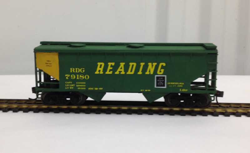

LOp Covered Hoppers 11 years 5 months ago #4441
Here is a pic of my LOp car it is an Athearn car with a roof from a roundhouse covered hopper.
