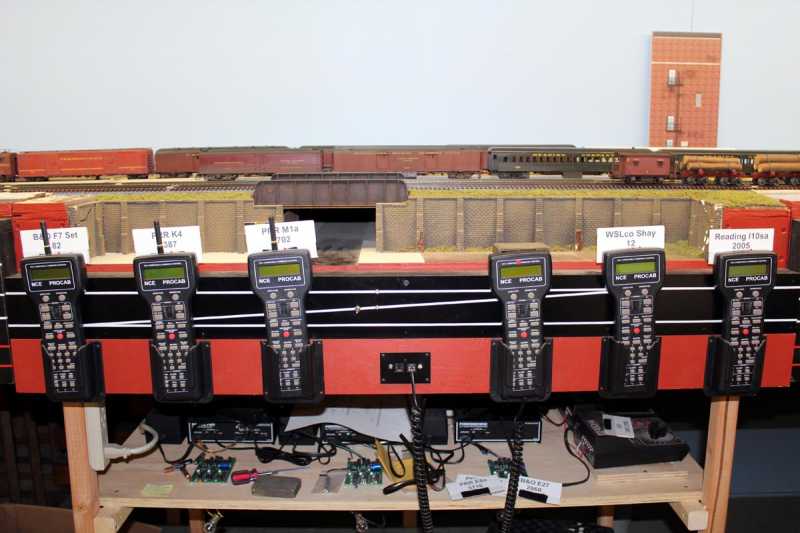

I would not consider it to be in the "good price" category but I am NCE all the way here. I am all wireless as well. (this is an old photo) The recommended placement for the base antenna is in the center of the ceiling of the train room. Mine is sitting on top of the rest of my power system under the layout.
I have "run my trains" up a flight of steps and through a block wall from my shop 20+ feet away without issues. It has never once lost signal or connection. The response is just as good as corded handles.
Finally - I LIKE the big handles. One button does 1 thing most of the time.
