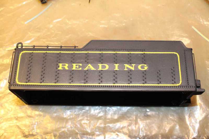

1 more side of the tender and the major decaling is done. I did not know at first that the corners were jagged, not a smooth radius.
Those tender stripes are just tons of fun. :P I floated out 8 pieces of decals (4 corners & 4 line stripes) live for over 1/2 hour before they started to make me happy.
There was a few little detail decals my friend forgot to make for me, and I still have to get. I need the headlight number board which we have discussed. I also need the G-1sb decals for under the cab numbers.
Was there a G-1sb marking on the engineer's side of the front pilot in the mid 50s?

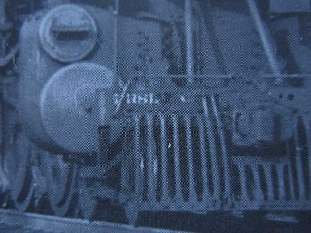

To help your question out, yes the pilot markings were there in the '50's, and better yet here is the pilot of G-1 134 on the PRSL.
Pilot markings 11 years 3 months ago #4550
the firemans side had "CTE" which stood for Camden Terminal Enginehouse
Pilot markings 11 years 3 months ago #4551
If the above is true the PRSL and CTE were on opposite sides on PRR locos. It figures! I thought I saw the loco class on the engineer's side of the front pilot beam. Yes? No? In a different era than the 50s?
Pilot markings 11 years 3 months ago #4552
Only saw terminal assignments on pilot engineer or otherwise/
I think G was Gordon... I don't have my list handy - GS was Green Street
R Reading, RU Rutherford - etc.
Pilot markings 11 years 3 months ago #4553
