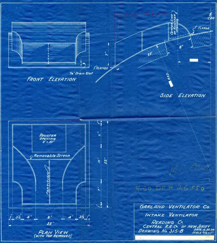

Hello Reading fans,
I’m looking for dimensional info for Reading coach roof ventilators. I have been able to find tons of pictures, but nothing with dimensions.
Can anybody steer me in the right direction?
Tom Stoltz

coach roof vents 10 years 8 months ago #5158
I think you can get them, in HO, from Bethlehem Car Works
coach roof vents 10 years 8 months ago #5160
Hey Mitch,
Thanks for the heads-up. BCW does have Garland arched roof vents, but not much of a picture of them. I was able to find a 0 gauge company that has several different types of Garland roof vents, however not picture at all this time. So the question becomes just what am I looking for? I am having trouble identifying the model of roof vent the Reading used.
Tom Stoltz
in Maine
coach roof vents 10 years 8 months ago #5167

coach roof vents 10 years 8 months ago #5169
Perfect, thank you very much,
Tom Stoltz
