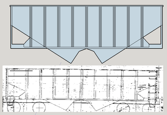

Well! I've been out of modeling for about a year, but i'm jumping back in. I'm traveling right now but I am working on 3D printing. I don't have my Reading Steam book, and I am looking for a side shot of these hoppers. I know for sure they were used a lot for ash around the Gordon complex, but haven't seen any other reference to them.
Does anyone have a half decent shot of the side? I have the measurements, but in my program it doesn't quite look right...
See attached. I am using Skethcup, and the top hopper I drew is according to length and width measurements from an Alphabet Route drawing. But the model I drew looks too tall, or the hopper angles are incorrect. The drawing i did over the picture looks much better, but is a scale 3-4 feet too short....Cant have that, so I need some help.
If there is no proto pic available, are the HTHj or HTo pretty close side-by-side?

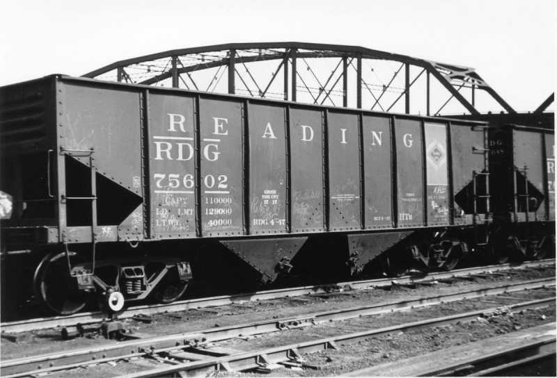

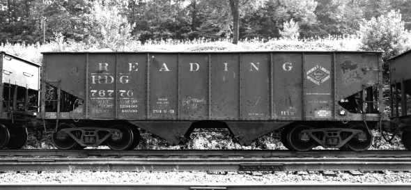

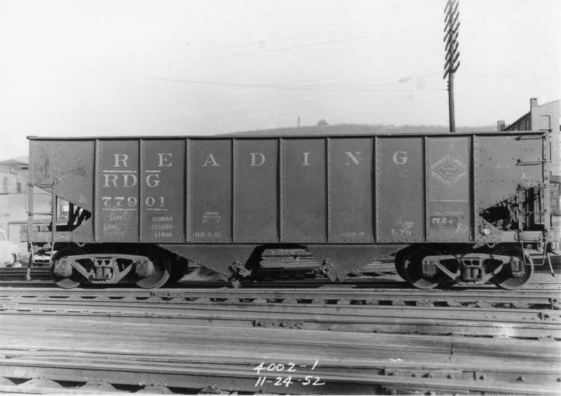

Here are three shots from my archives, they should help out greatly with your project at hand. Oh, and if you 3D print these in N scale, try one in HO to make a resin casting from. There is a definite interest in this hopper, Bill
HTh hoppers? 10 years 7 months ago #5227
