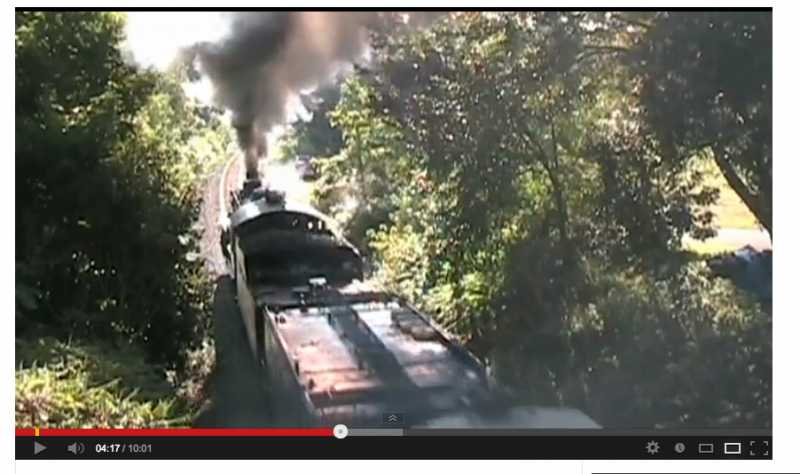

Looks like solid walkway with a split hatch, I suspected this but this is proof.
If the attachment didn't work I stumbled on a top shot in random youtube watching.
Right at 4:17, I have been trying to find this myself I have thinking about doing one for my I-10.
