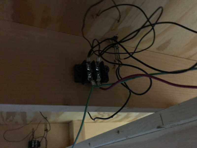

Although this isn't strictly a Reading question, I know that most of you have gone digital and would probably advise a fellow RDG guy. I'm contemplating converting to DCC and am wondering if I need to replace my old style Walthers' power routing turnouts. Each is thrown with Caboose ground throws with contacts, which connect stock rails to frogs. It would be easy to install bus wires under the layout and tap in feeders from the buses to the terminal strips I installed under the stock rails. I think I understand the advantages of "DCC friendly" turnouts (as well as their disadvantages), and I've even bought some for eventual replacement. I'm just not eager to tear up relatively trouble-free ballasted track work, as well as a couple of paved crossings. What do the experts think?
Thanks, gang! The picture's dark and the wiring''s ugly, but it works.

I am no expert, so I'll hold my thoughts, however it may turnout easier than you think. I have seen some pretty shaky (downright ratty) arrangements that still worked with DCC.
If you don't get a real firm response you could always drop a power lead form the power routing system and test one switch. The circuit breakers are usually really fast on the DCC system, so a short shouldn't drop out fast and not kill/fry anything.
Another question might be would the wiring for the DCC circumvent the need for power routing? I was once told by someone that was pretty good at the subject, even though it is DCC, insulate the turnouts just like you were running the old block systems.
BTW - your wiring looks better than some ADT burglar alarms I've seen - so you have that going for you.
