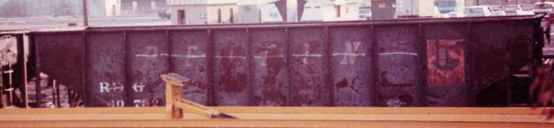

Back on cold New Years Eve, I believe 1981 (but may have been 1983) Back when I thought we needed to look for every Reading freight car and document the Conrail to Reading transition numbering, I was walking a line of gondolas sitting on a siding in Pottstown looking for Readings and jotting down numbers. It was nearly dark and I get to the end of that line and inside the fence at the former Steel plant there I see a string of whitelined HTw hoppers, and before my very eyes....... two Anthracite heralds staring back at me. Well Holy Shitsky Batman. I was impressed as I had been seriously railfanning/researching the Reading for about 5 or 6 years and never dreamt that I would see or take that picture.
Turned out the cars were being rebuilt and shipped out of the country by a rebuilder using the steel mill as a base of operation. I believe that was Eastern Car Builders, or something to that effect.
I'll post those photos as soon as the memory and the pictures end up at the same place and same time. SO you have a pretty broad range of being able to use that paint scheme on your layout.

When did the Anthracite herald appear on hopper? 8 years 11 months ago #6060
OK so it was 1982
