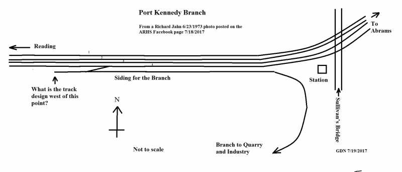

Richard Jahn posted a 1973 photo of a short train on the Main Line near Port Kennedy on the ARHS Facebook page. The photo shows the train on the #1 track of the four-track Main Line with Sullivan's Bridge and the Port Kennedy Station in the background.
Comments indicate the Port Kennedy Branch includes a siding on the right side of the picture that leads to a curve turning south in the distance right before the station. There is a crossover in the foreground that lets westbound trains on the #4 (southmost) track move to the siding.
What was the track configuration of the branch from that crossover to the west? Was there another connection to the #4 main track allowing westbound trains on the branch to return to the #4 main track? If so, how much further west was it (car lengths, yards)?
Refer to the attached diagram for clarification.

According to a 1/4 mile sheet the track ended in an earth bumper about 650 feet west of the crossover. there was also a spur leading to a coal dock between the crossover and that bumper.

The orientation of the crossover means trains for the Port Kennedy branch would have to be shorter than 650 feet so they could clear the cross over.
Is it correct to assume trains serving the branch would be westbound (from Abrams or Norristown or ?)? Would they use the cross over to get the the siding and take it to the end. Then would they back into the branch. The caboose would have to be coupled behind the locomotive to allow dropping or picking up cars.
