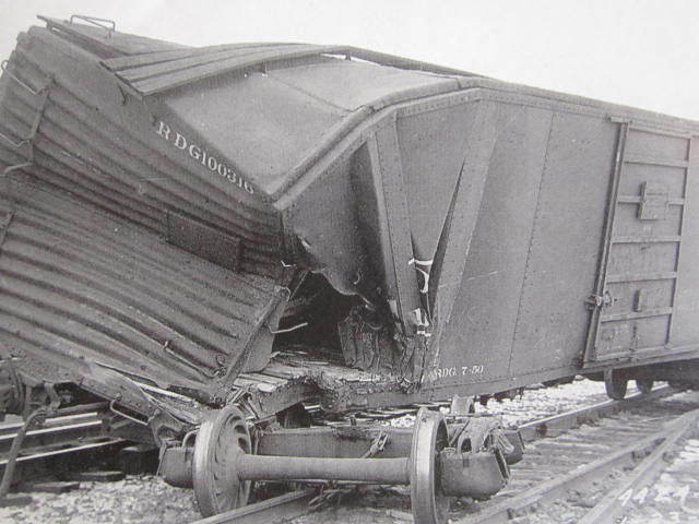

I was going through some of my Reading books and possibly came up with validation to the roof mystery. In Reading Diesels Vol. 1, page 112, the photo must have been taken from the Spruce St. tower. If you look to the left the Murphy ends are quite apparent, along with the lack of any external roof ribbing. The boxcar also sports a six panel Superior door, unfortunately a car number can't be identified for modeling purposes. Now, smash an RS-3 into one, as seen on the rear page of the Bee Line Vol. 3 of 1997, and the roof mystery solved. I knew it was somewhere buried in my library!
