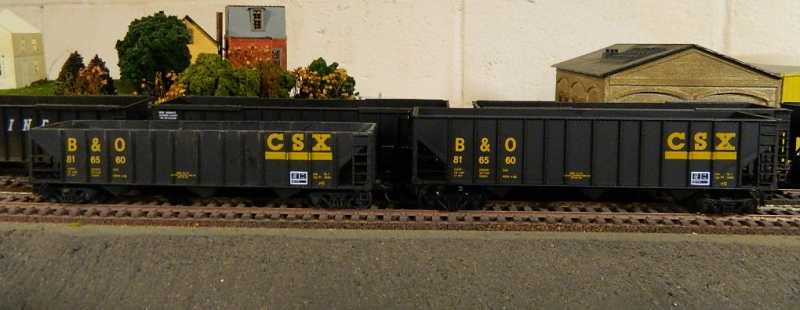

That is exactly the conversion I am working on. Somewhere in life, I acquired several dozen Life Like hoppers real inexpensively. Some Reading HTg, Some Reading HTd or e, and some CSX/B&O. The plan is to chop the tops off, then slice the top off right below the rivet line and put them back together. The second part of the plan is to reframe them. These are old cars so they have "talgo" trucks with horn hook couplers attached to the trucks. I have a about a dozen McKean 100 ton hoppers. Nicely lettered with Reading speed from the RCT&HS project many moons ago. Of course they are welded cars, not riveted. It was what was available back in the eighties. So I will keep a couple intact for the display shelve (- history?) and the rest - I will pirate the frames. That drops the whole car down - looks better.... I think. The car on the left, chopped down, but the top has not been completed yet. On the right the untouched LL.
Last Edit: 12 years 5 months ago by Rob.
HTz 40001 - 40400 Hoppers 12 years 5 months ago #3106
Your frame mod does look good. That low slung "rake" is an important modeling feature, even though you usually have to carve out some of the carriage to get wheel clearance. Those LL hoppers are great late-era kitbash cores. I bought up a bunch of them as well, specifically to make HTz's, but then changed my era. As a novice project, I wound up just shaving down the stock bolster pad flush with the frame and sticking the talgo trucks back on, sans the horn hook box. Not real pro, but it tracked pretty good.
