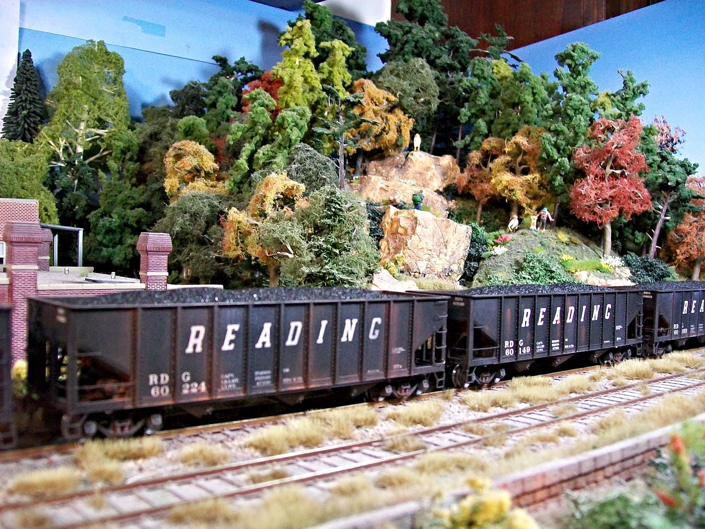

Show Us 11 years 9 months ago #3838

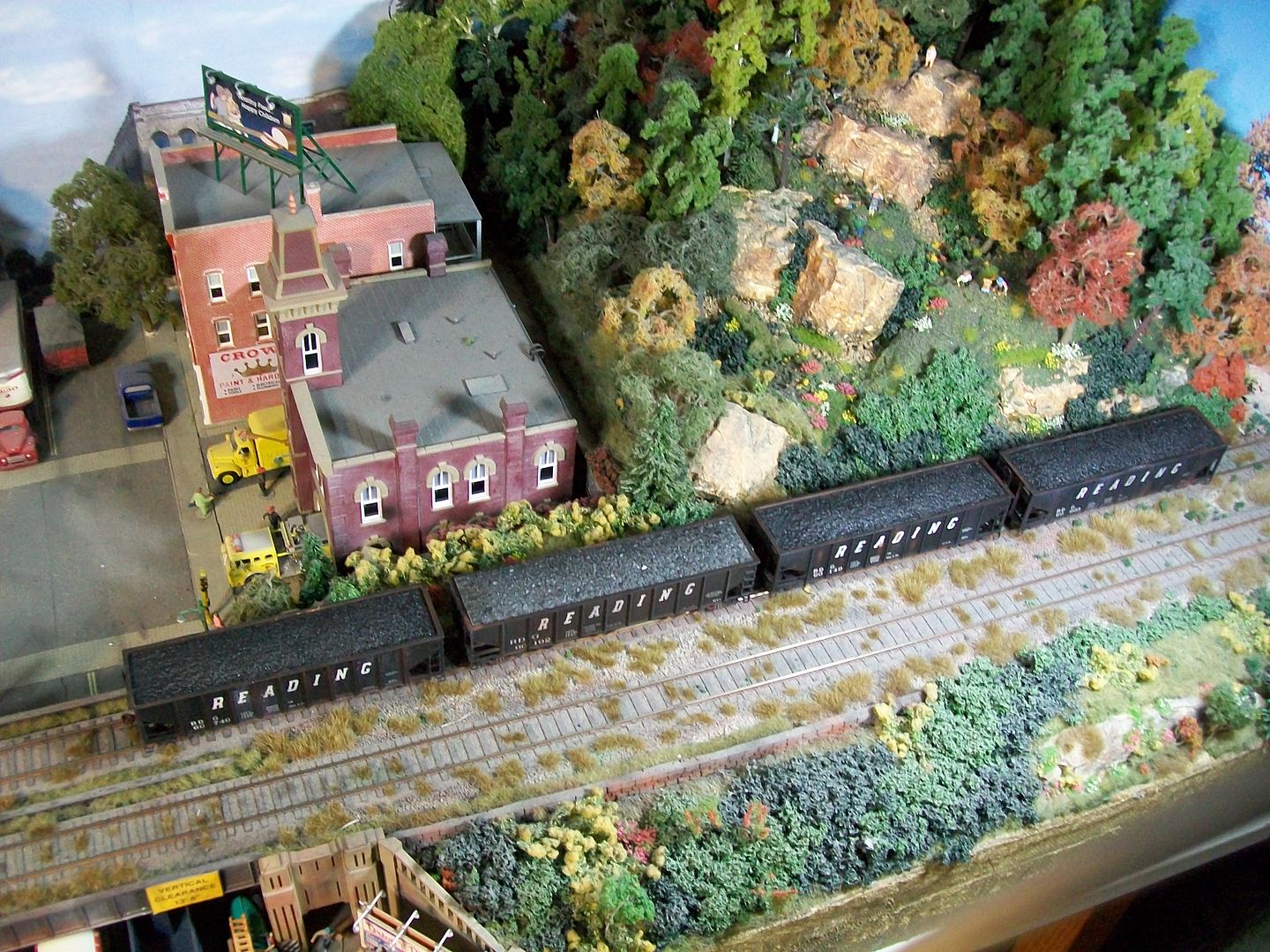

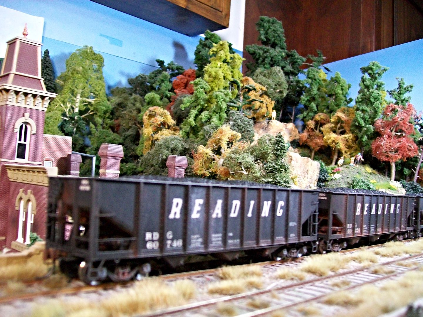

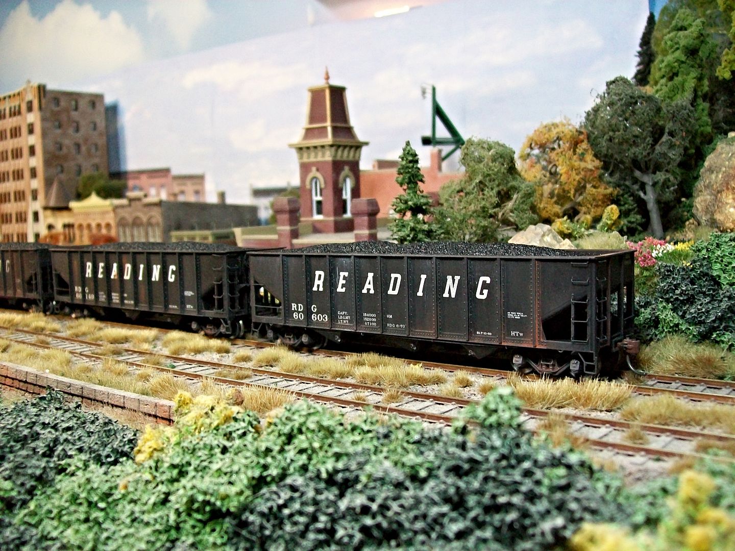

Added weathering to four Athearn and one Atlas HTw hoppers.The trucks and wheel faces were painted grimy black and the weathering affect were created using black,white and rust colored powders.All sealed with dull coat.
Bird's eye view of the four Athearn's
Side views.

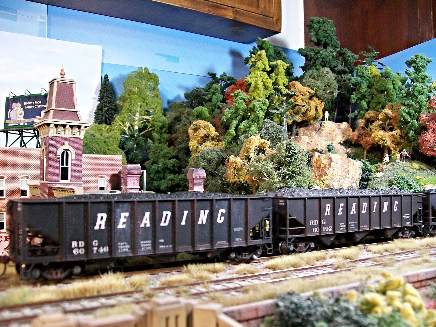

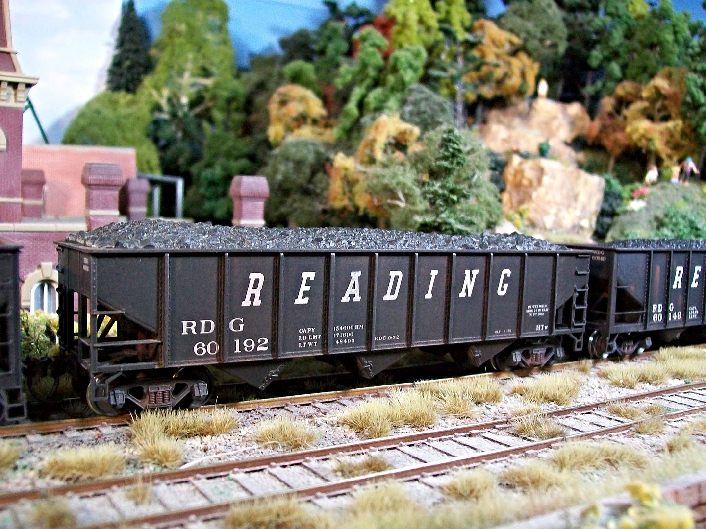

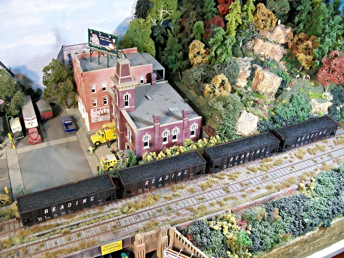

Like I said I also worked on one of my Atlas HTw's.The Atlas unit is a bit longer,wider rib spacing and better interior detail.Athearn did do a good job with the addition of metal grabs and all the piping.
Overhead shot,the second unit from the left is the Atlas unit.
Athearn and Atlas side view.
Close up of the Atlas unit.
So when it comes to car length which is correct?

Hello Chris,
Great work as always! Regarding your question about the difference in dimensions between the two models; maybe you can find the drawing for that class on The Alphabet Route website and see which is closest to being correct. Just off the top of my head, I seem to recall reading that the Atlas model is more accurate while the Athearn is off. Isn’t the Athearn version just a rework of the MDC model? Don’t know, but I’m sure someone here does.
Does anyone know if the RCT&HS has one in their collection?
Regardless, it has been a while since someone produced a nice, accurate Reading hopper based on “new” tooling. Probably our best bet for that is Bowser.
