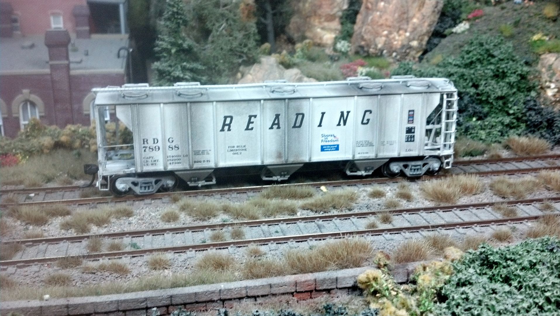

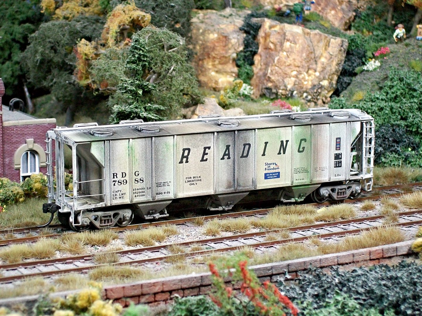

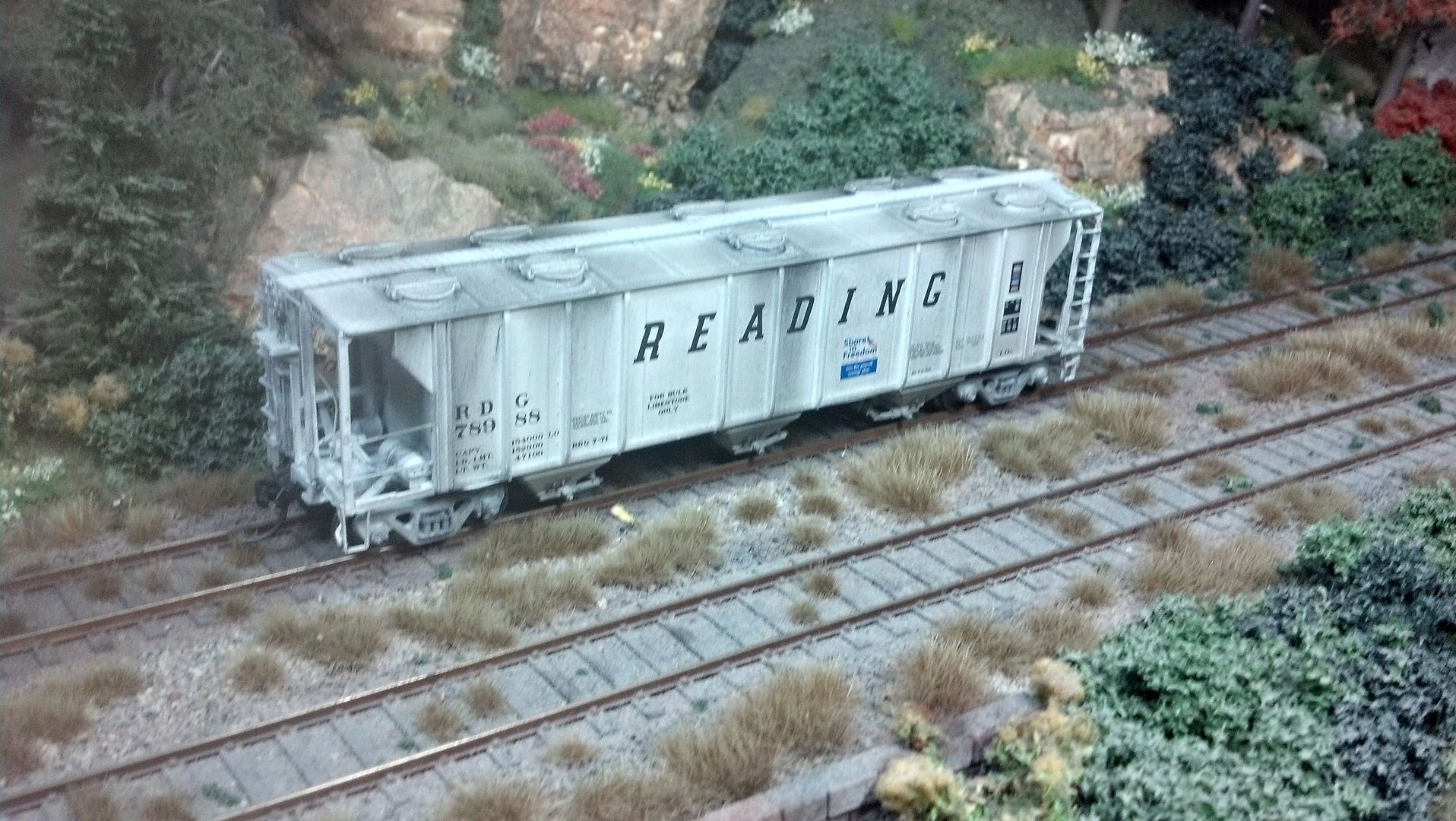

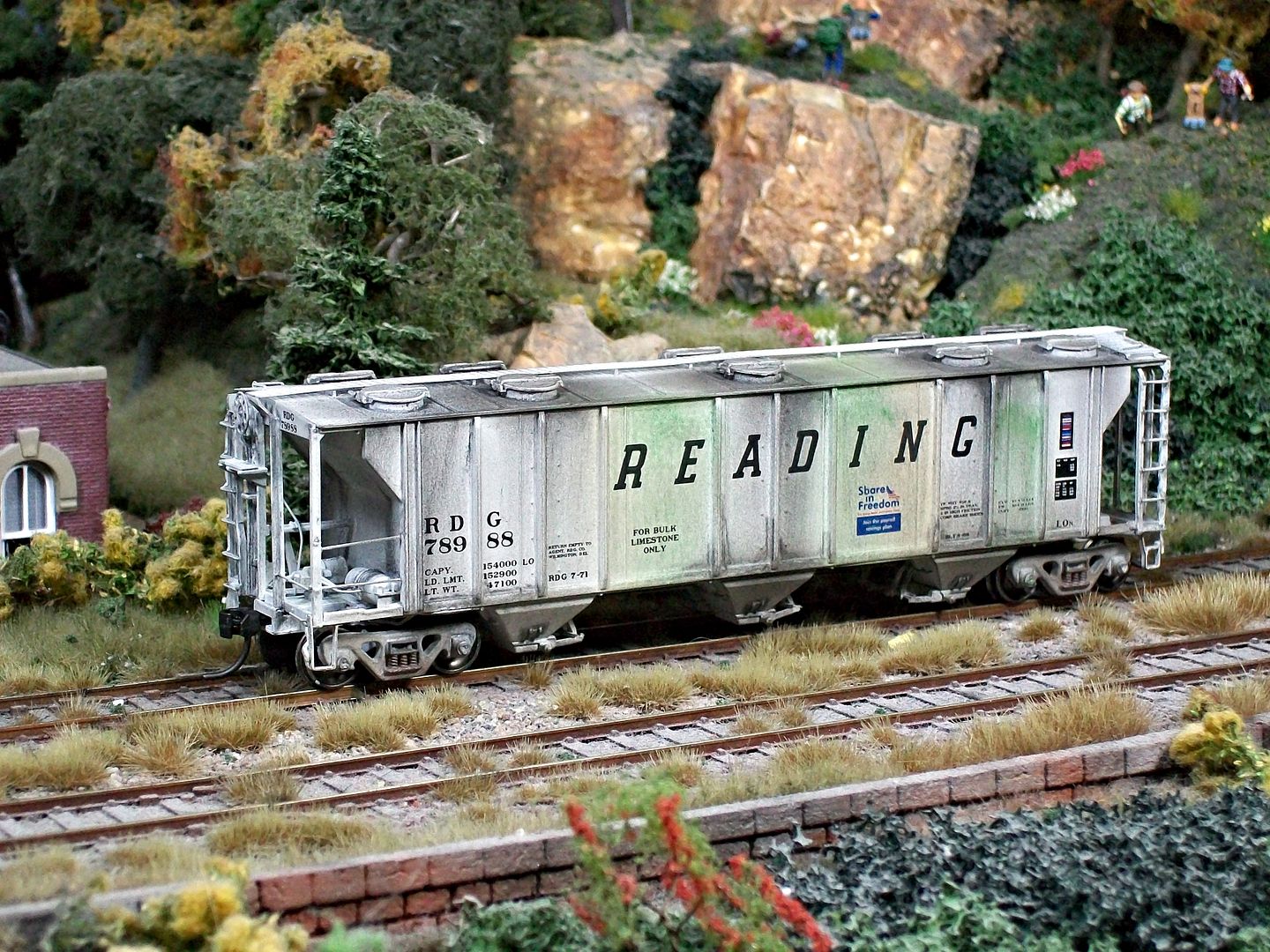

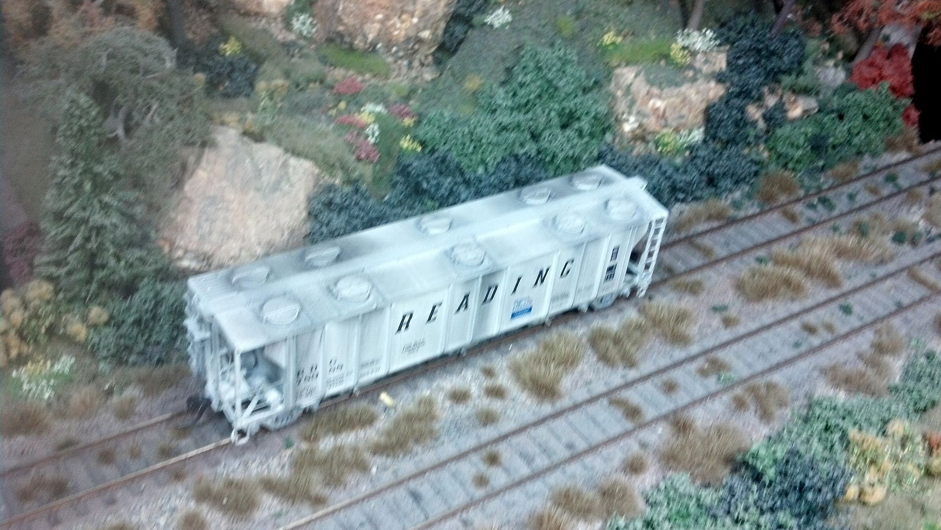

I picked up the three RDG covered hoppers offered by Athearn and completed the weathering on one of them.I know the units aren't correct for the RDG but they are nice looking.
I replaced the trucks with Athearn's 70 ton roller bearing trucks and painted them gray.Added Kadee's and weathered.
Top view of 78988
Side one
Side two

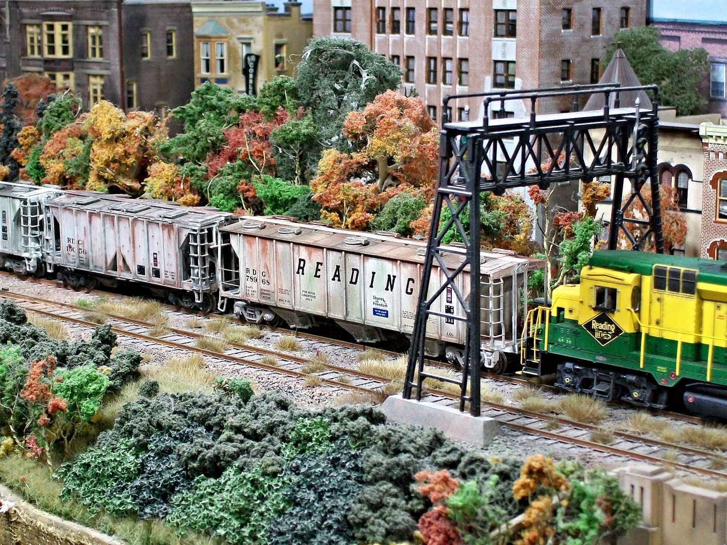

Three pics of the power used on this mornings coal train.
Sorry for the picture quality.What I wanted to point out in these views is the difference in the shade of yellow.On my last eight engine projects (4 P2K 30's 3618 included,2 P2K SD45's,1 P2K GP7,1 Athearn SW1500)I have used poly scale RDG yellow with the red label.When it was announced that the PS line was being discontinued I picked up all I could find.3620 is the first unit I painted using PS RDG yellow with the newer white and blue label and it definitely has a more orange tint to it.So even when made by the same manufacturer the batches are slightly different in shade.When running together that slight contrast does look good though.

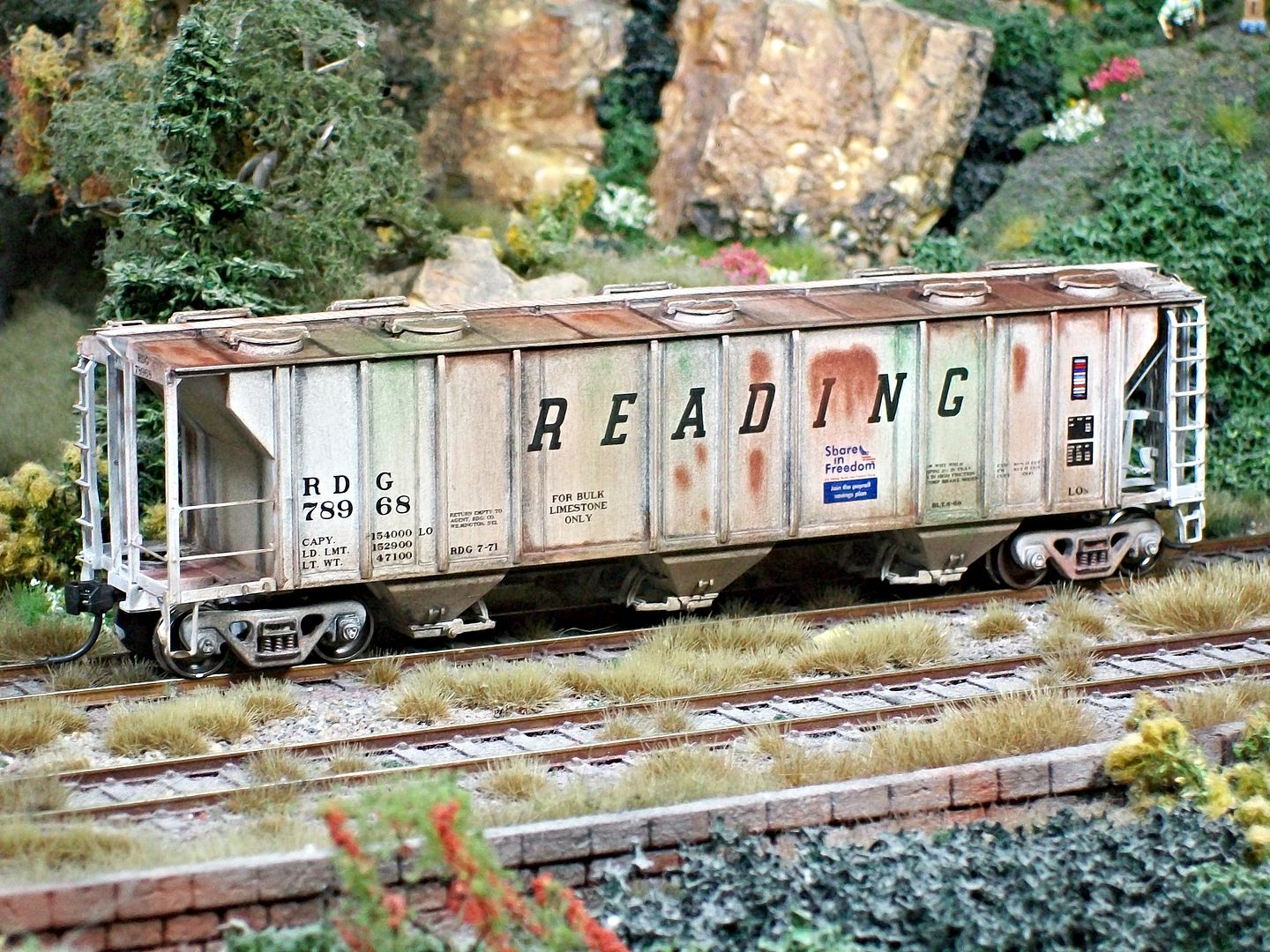

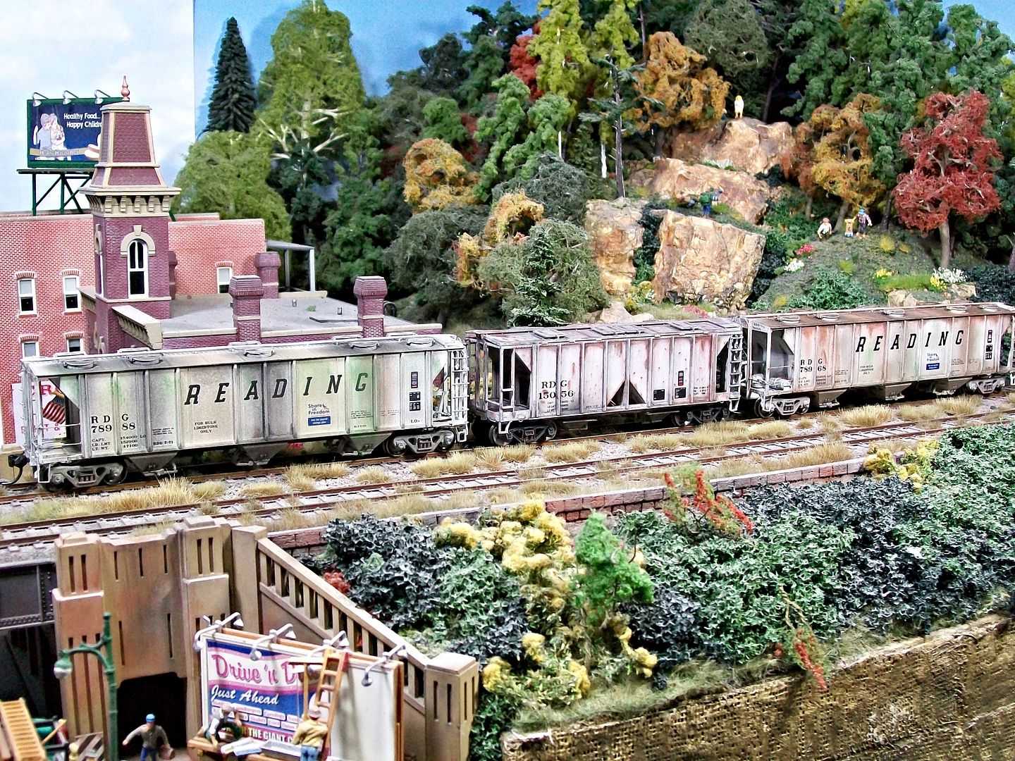

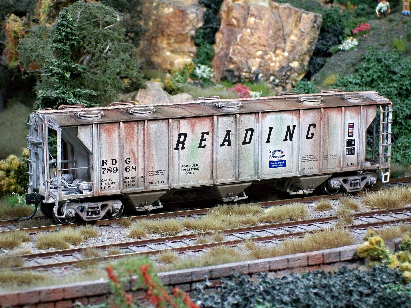

Worked on some weathering...added more to my previously posted 78988
Got a little carried away with the application of the green patina.
Next up 78968
Also assembled a Bowser offering 15056
All three together.
Three EMD's pulling
