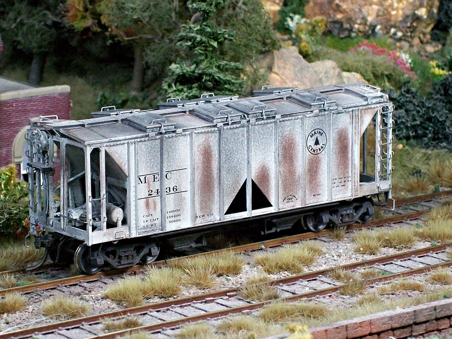

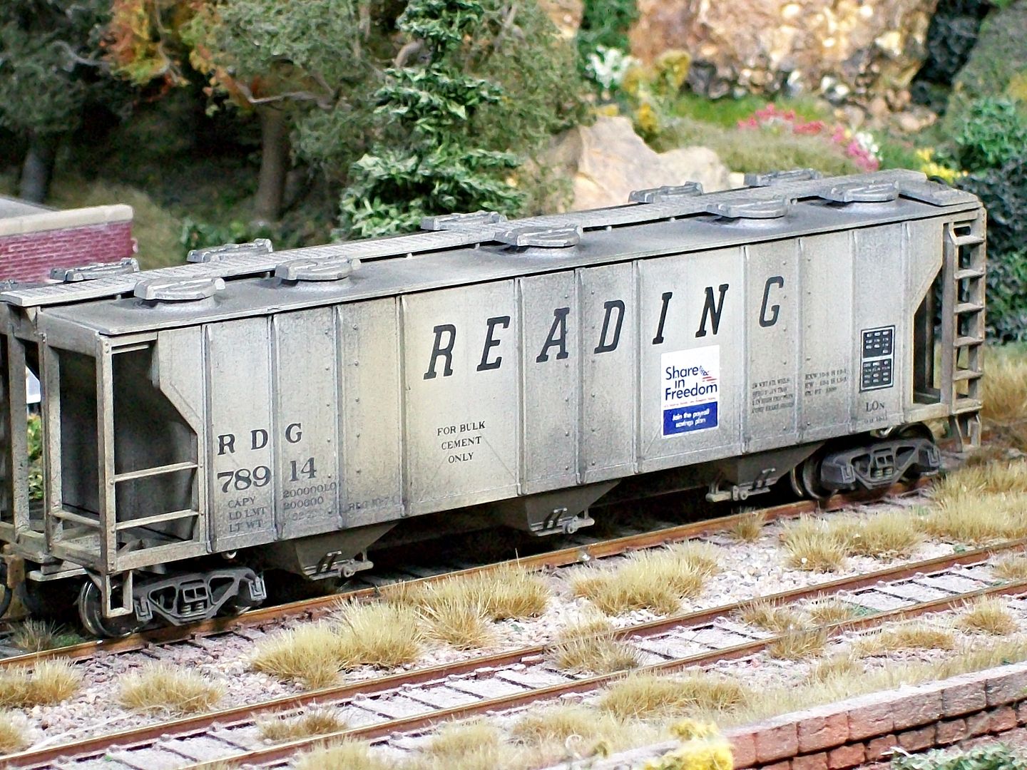

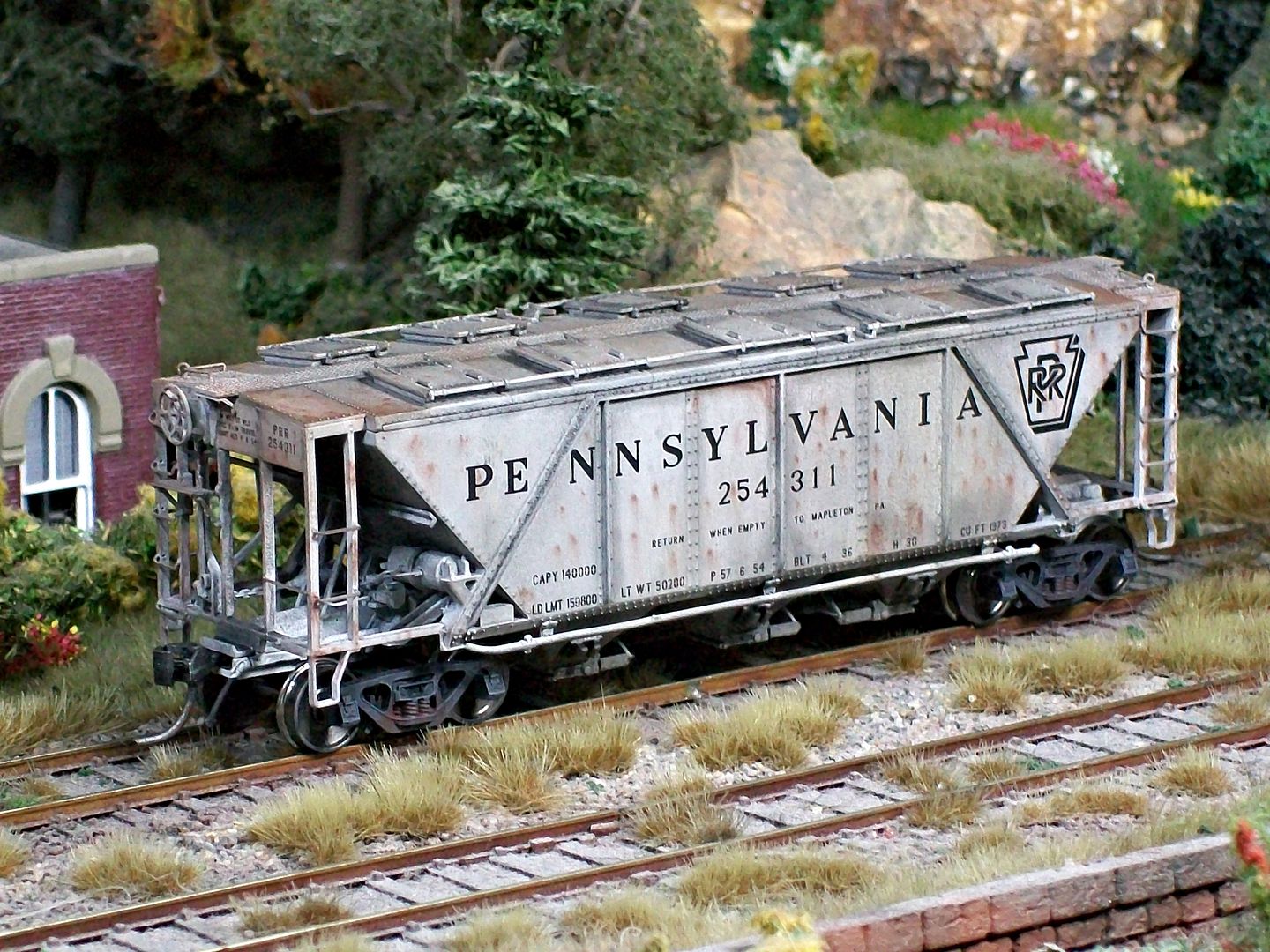

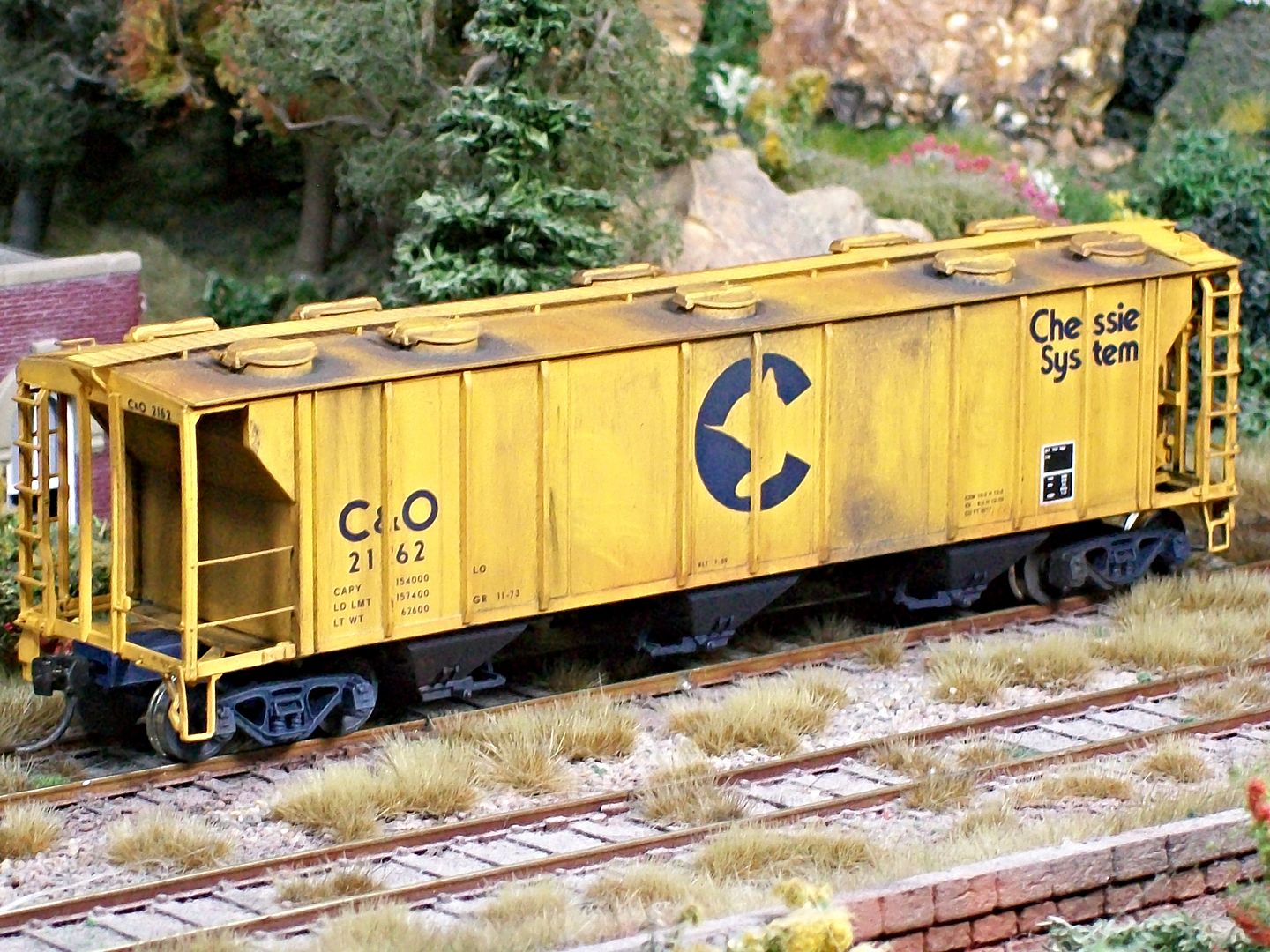

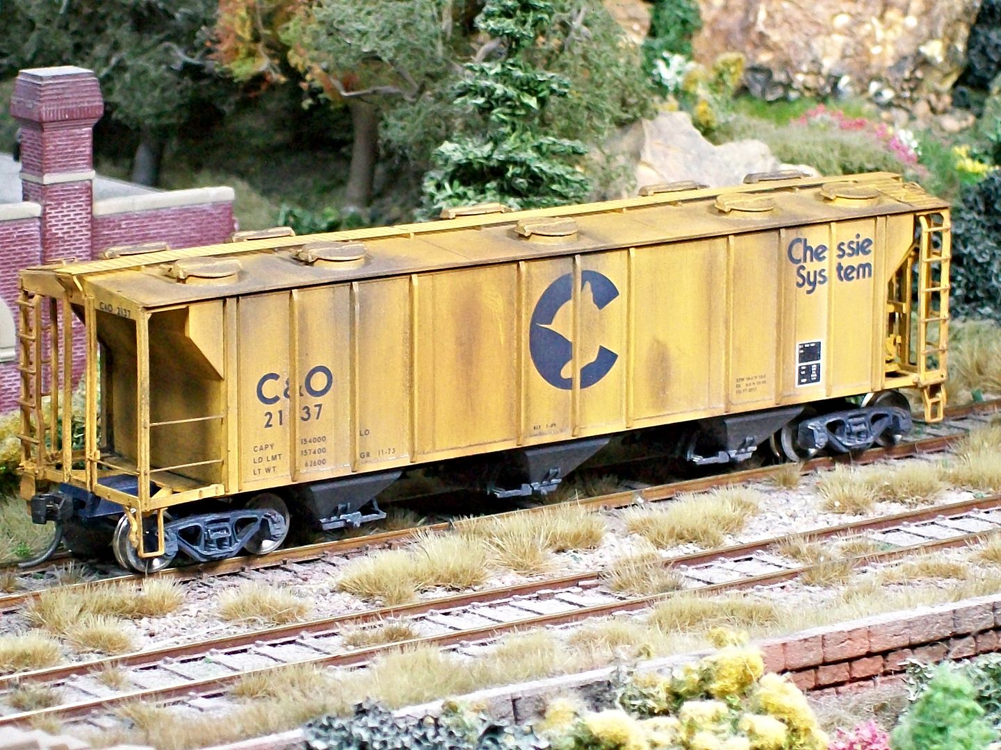

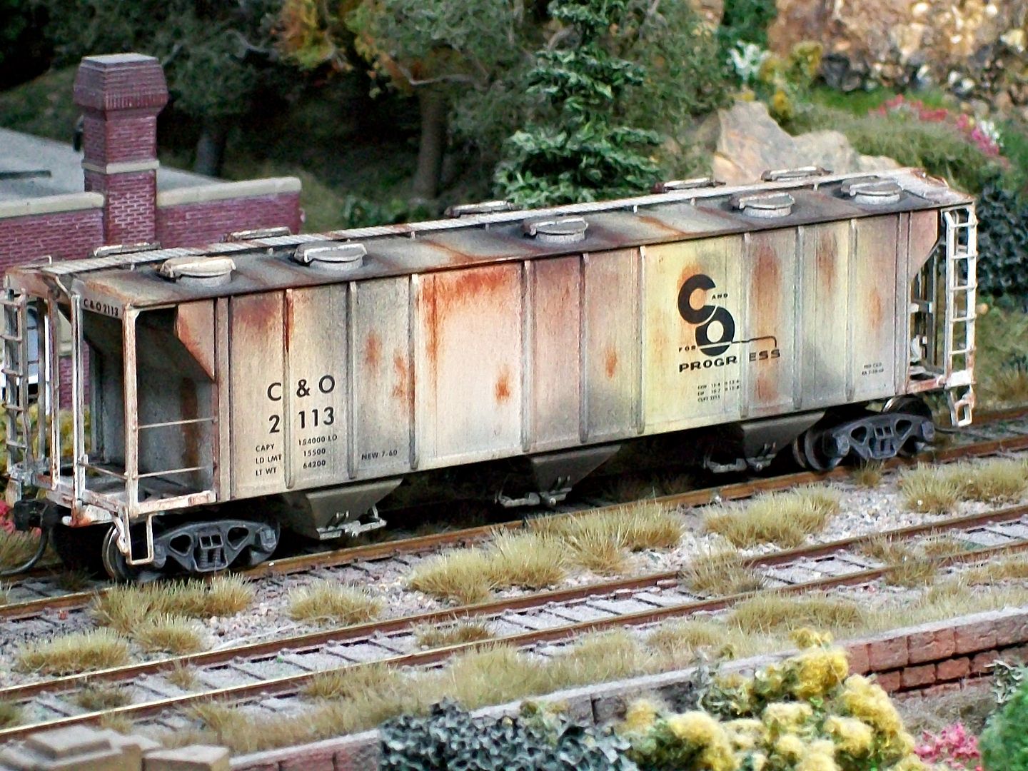

Nice weathering! What technique did you use for the brown rust spotting on the second and third cars?
Show Us 11 years 6 months ago #4285
Thanks Turbo...I use the AIM pastel powders and apply them with micro brushes.After each application I seal the effect with dull coat and repeat the process till I'm satisfied.What loose powder that remains I use a wide brush and drag it down the side of the car before sealing.
For the spotted rust I dip the tip of a medium micro brush (green handled) into the desired rust color and dab it onto the model and then use the wide brush down the car sides.
Having a prototype picture helps with what your trying to achieve.

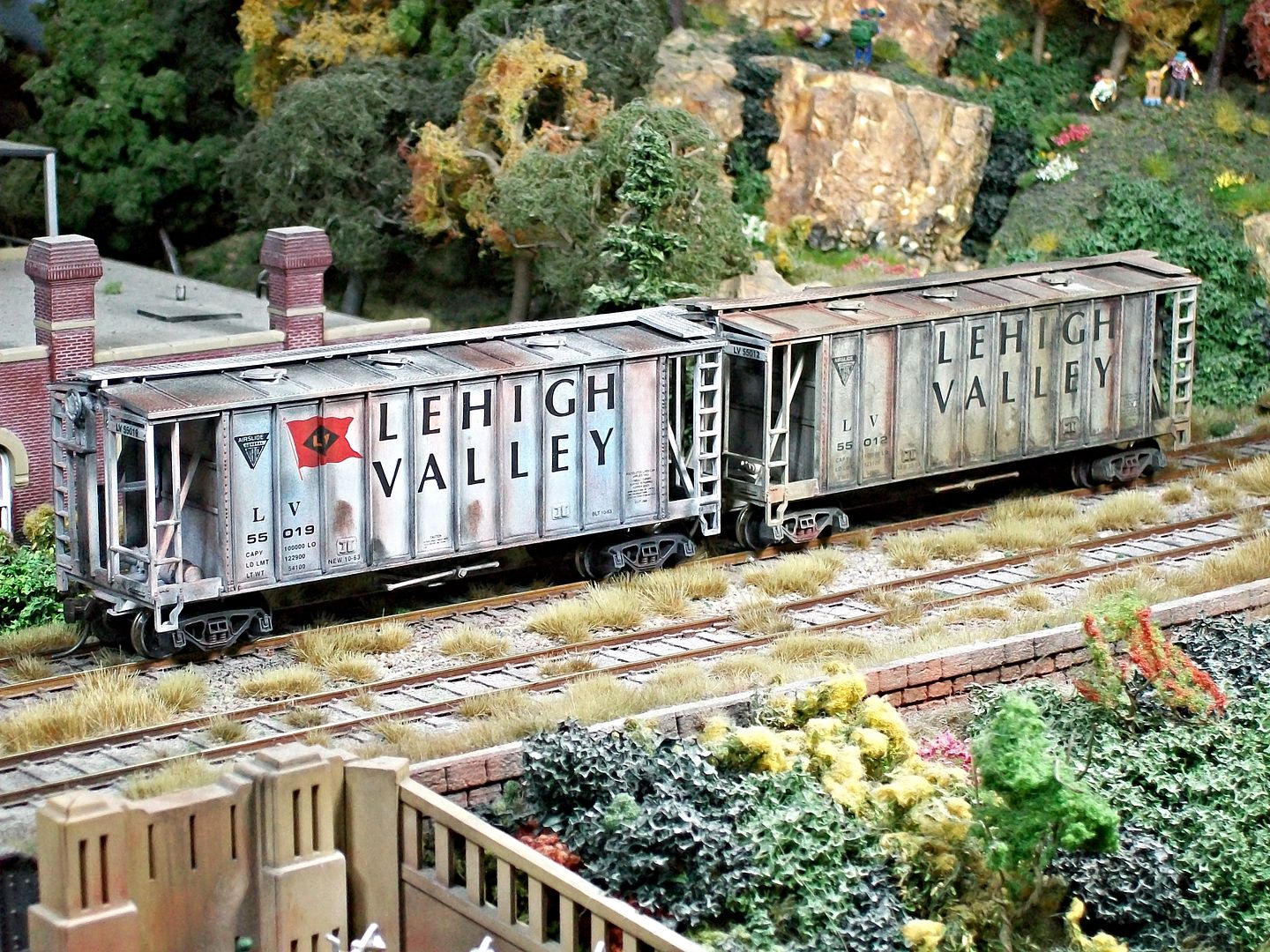

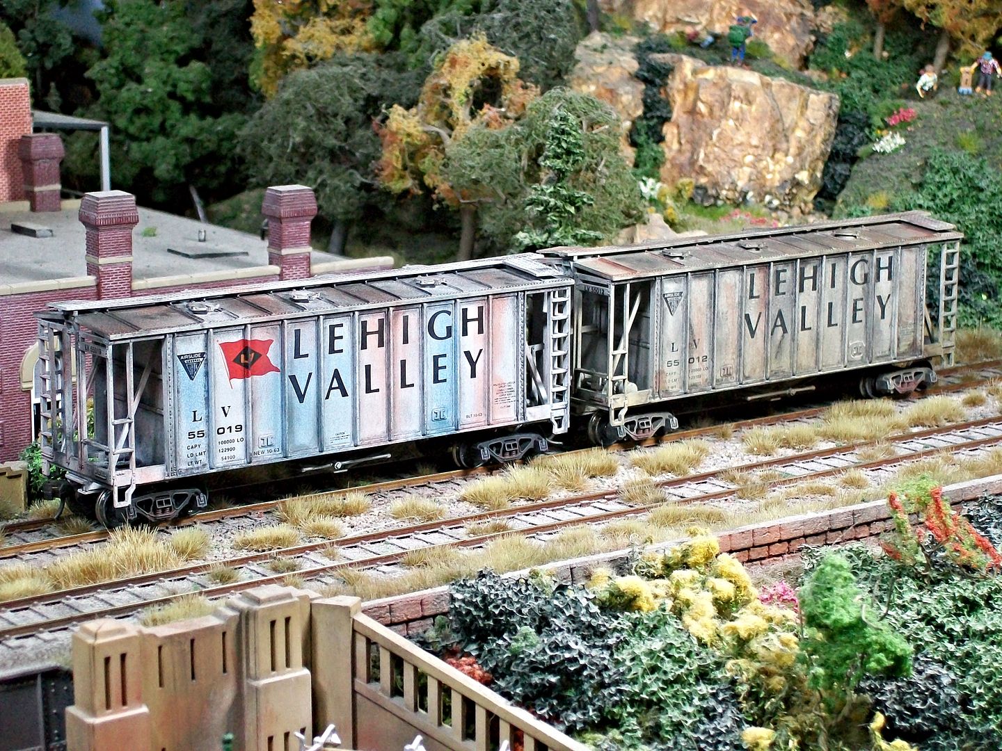

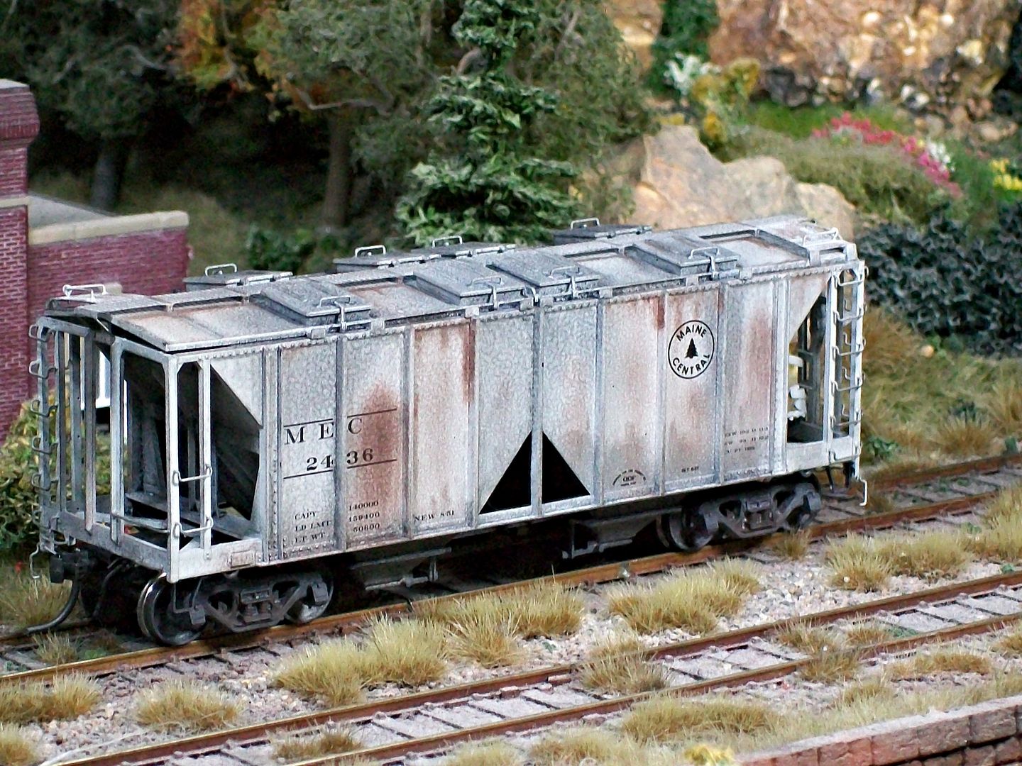

Been busy adding weathering to my covered hoppers used for cement and lime stone service.
First up a pair of LV units.These were offered by,I believe,Rail Graphic in a three car set years ago.I used AIM powders on these units.
Sides 1
Sides 2

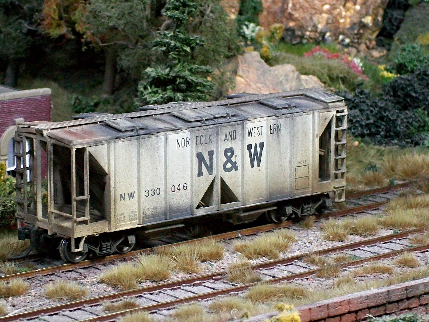

This next unit is a Bowser offering I picked up last week.This is really a nicely done model.I also used AIM powders on this unit.
Side1
Side 2

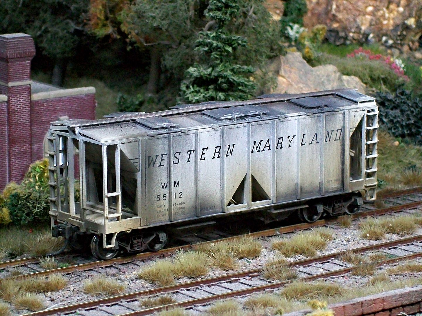

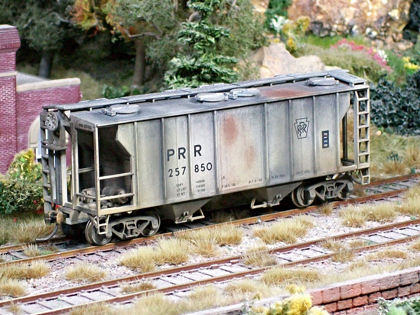

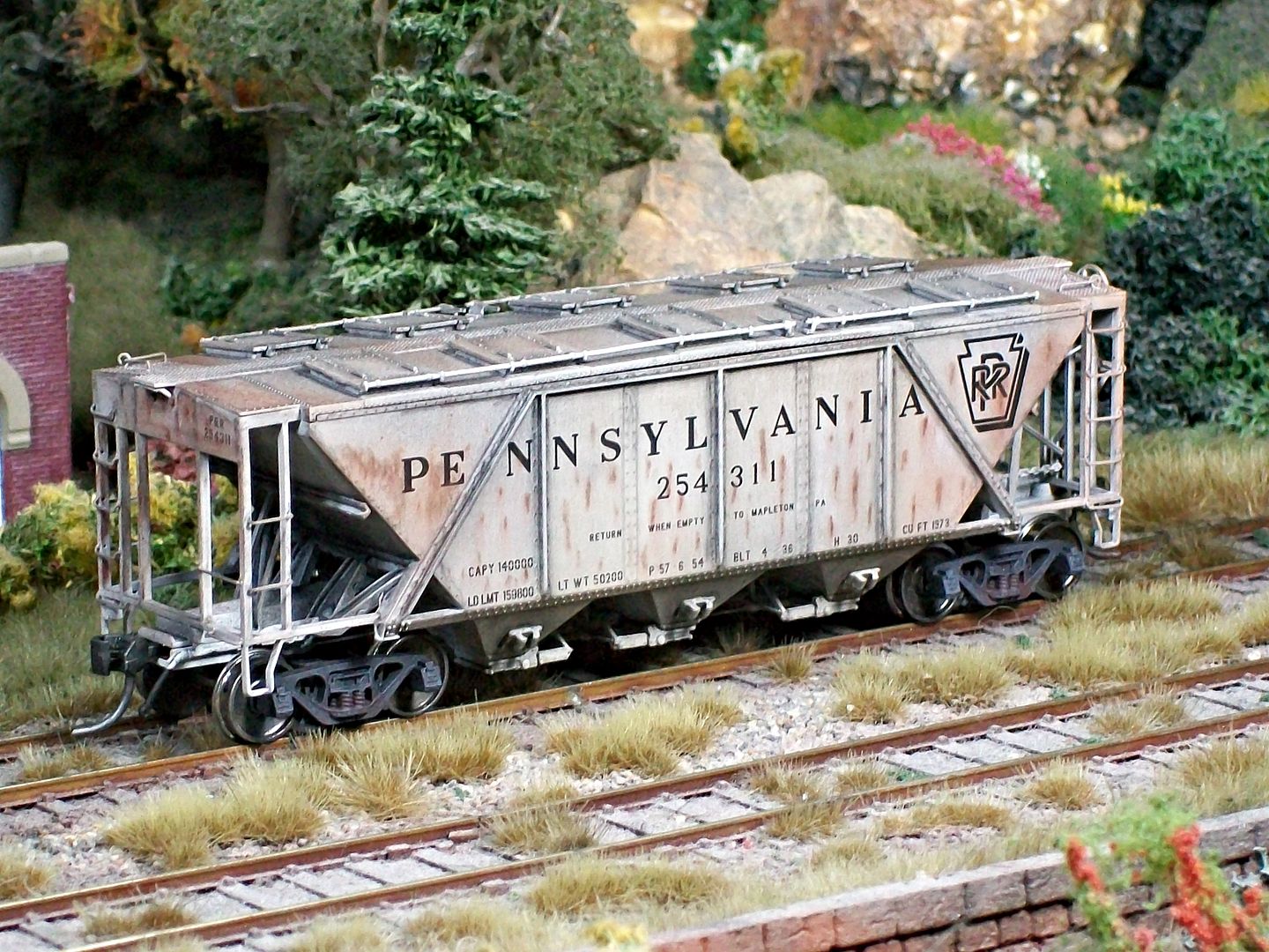

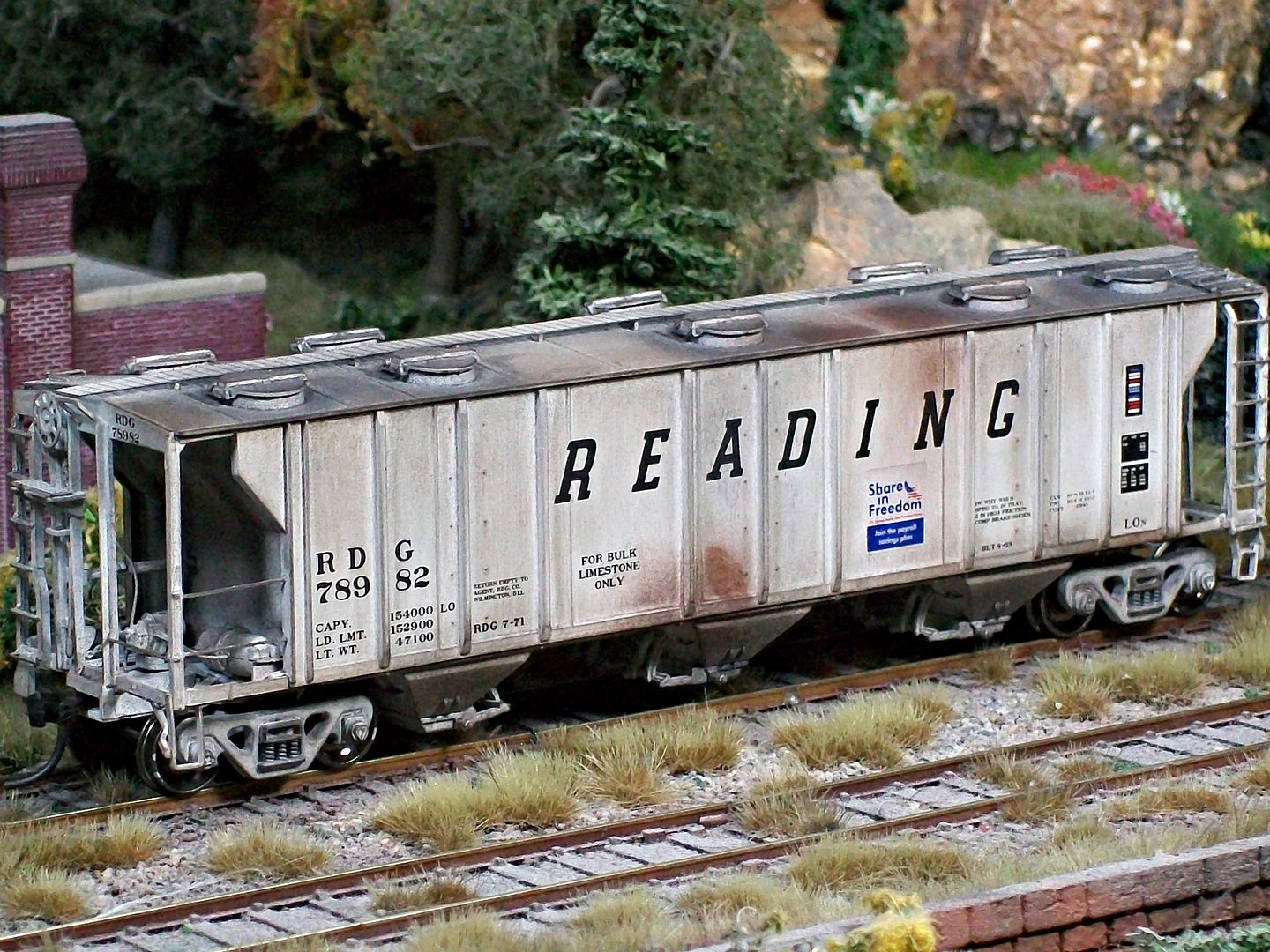

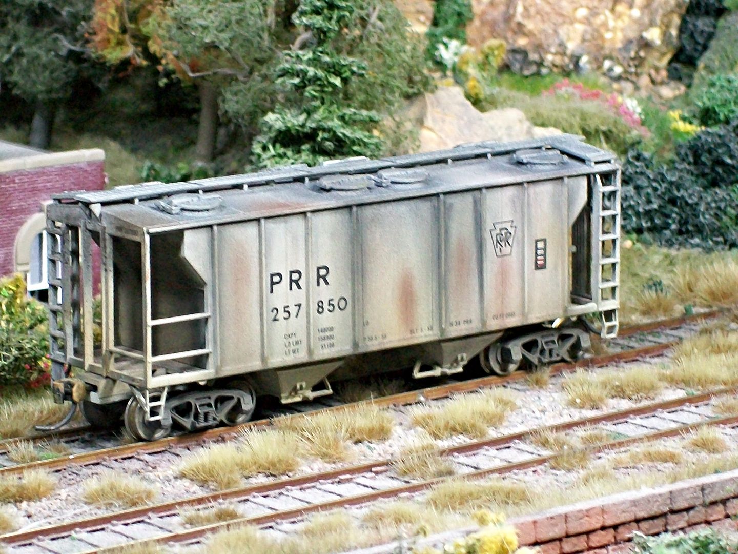

All were sealed with dull coat.All of the following units were weathered using Pan Pastels and I liked them better then the AIM products.
Show Us 11 years 5 months ago #4365
Ok where was I? The following were done using Pan Pastels and the material was applied using various sized soft brushes including micro brushes.All the trucks were painted a weathered black.

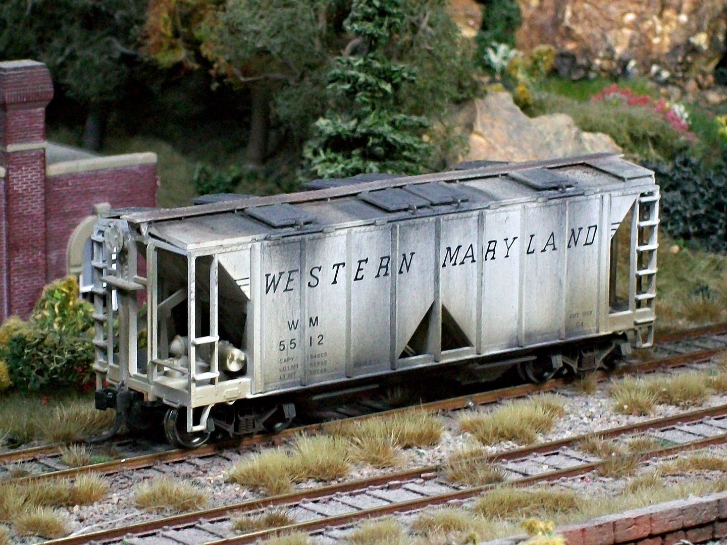

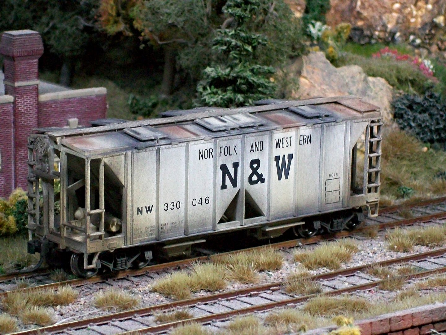

The next are Bowser offerings
N&W side 1
Side 2
WM side 1
WM side 2
An Atlas PRR
Side 2

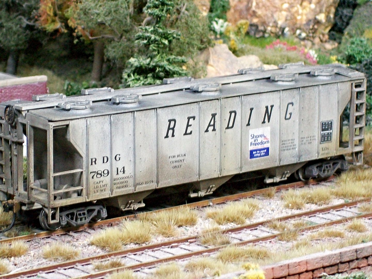

Con Cor RDG hopper
Side 2

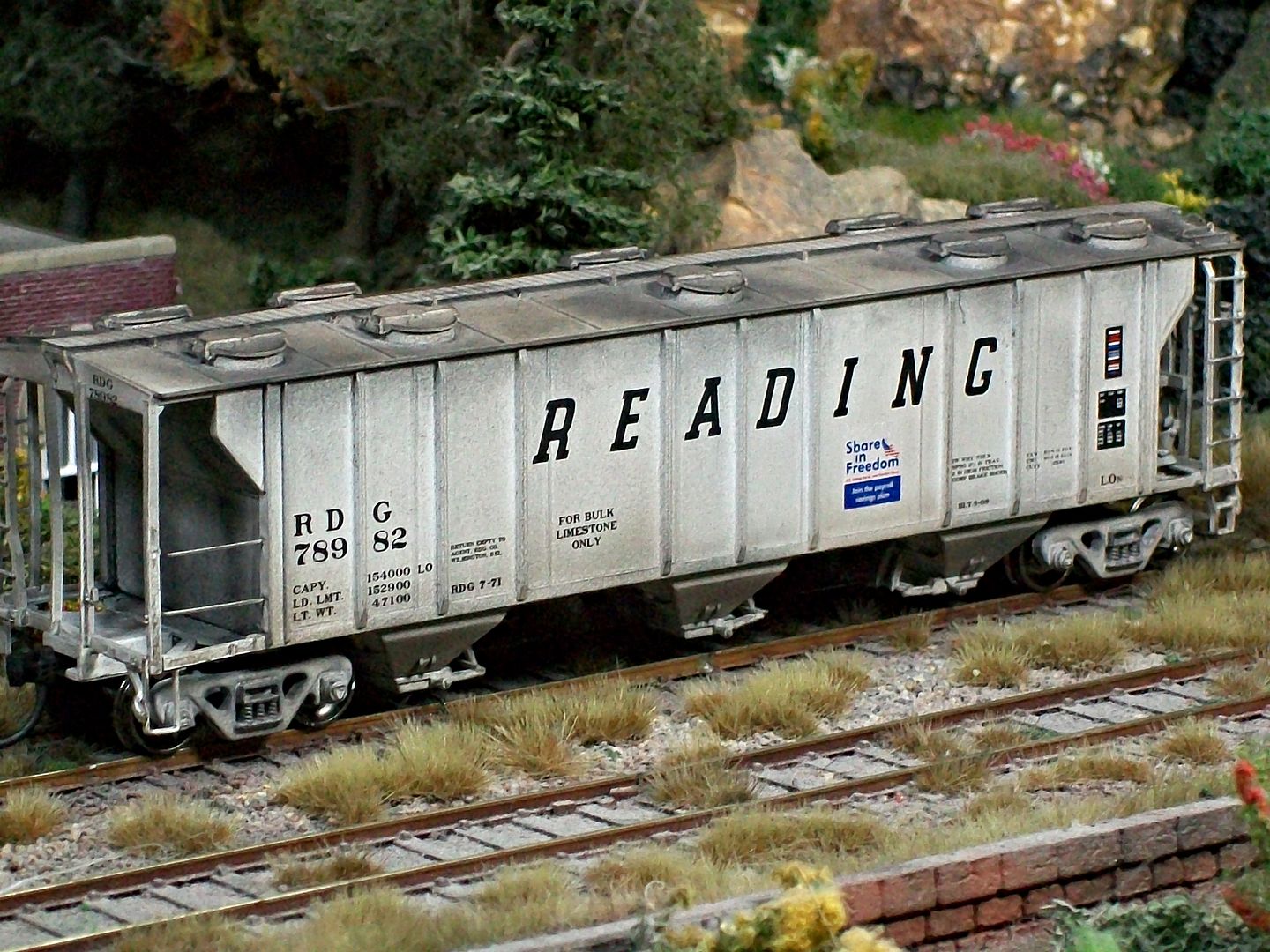

My third Athearn RDG hopper
Side 2

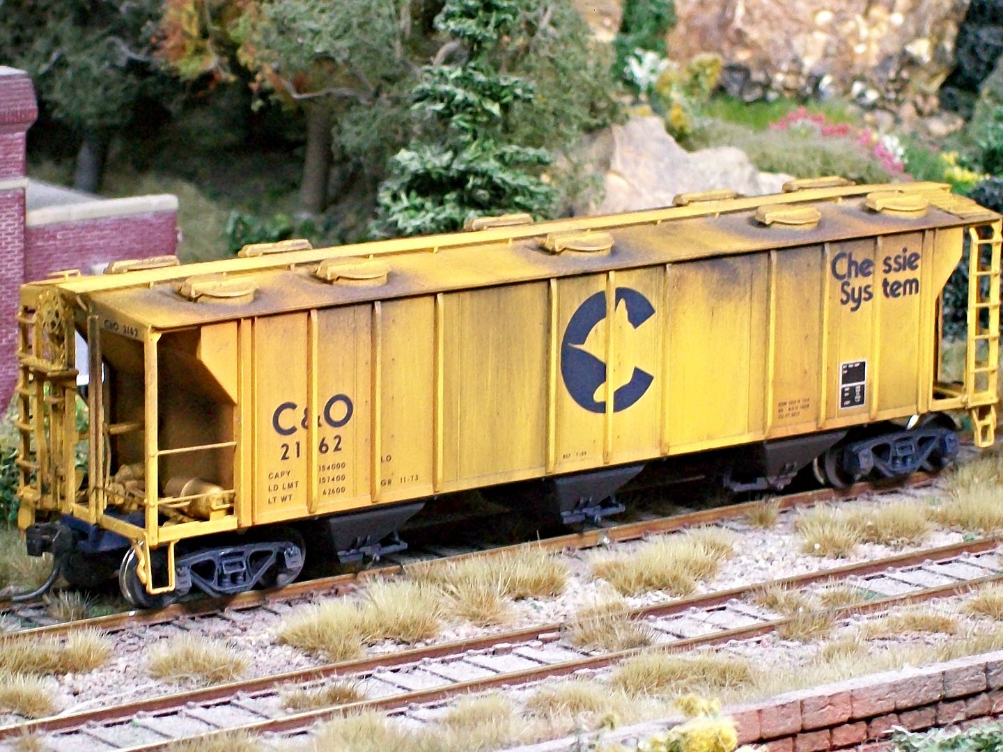

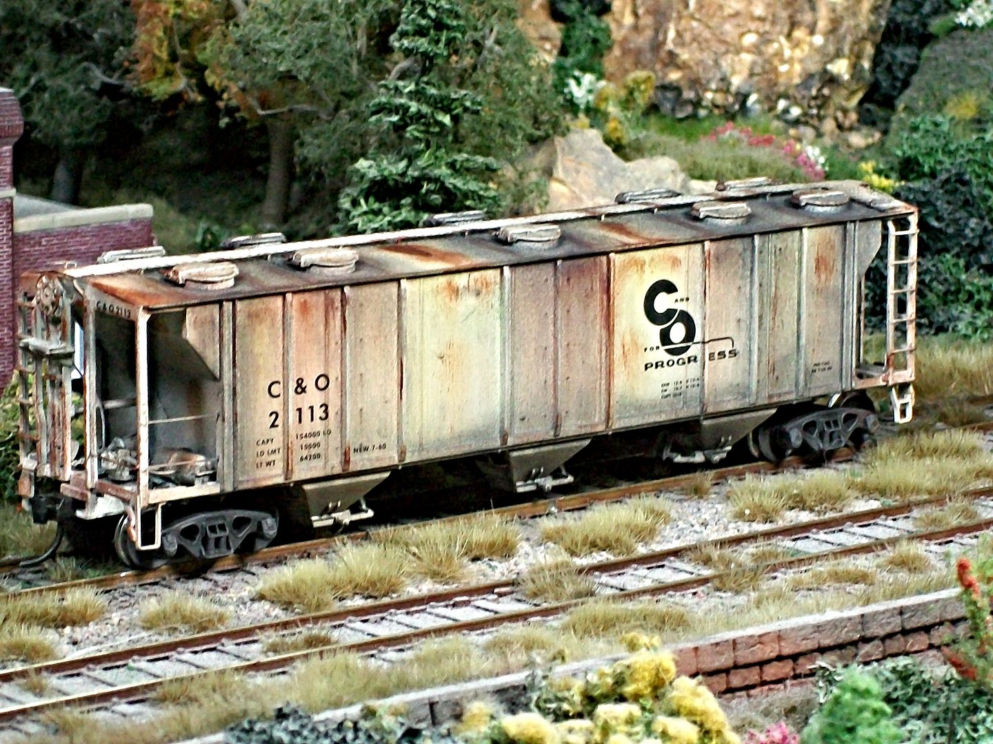

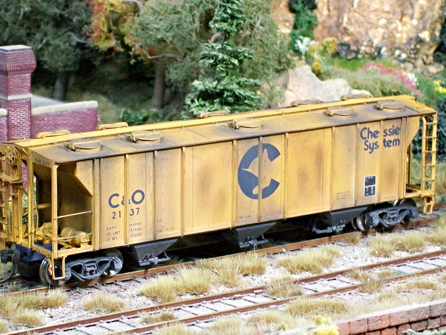

An addition Athearn C&O
Side 2
I added some additional weathering to the two C&O cars that I posted earlier.Wanted to simulate spilt commodity.
Side 2
Side 1
Side 2
