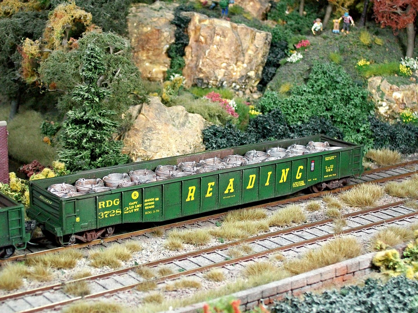

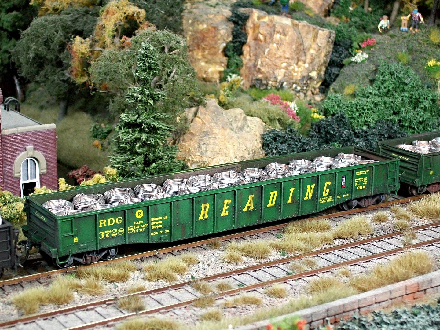

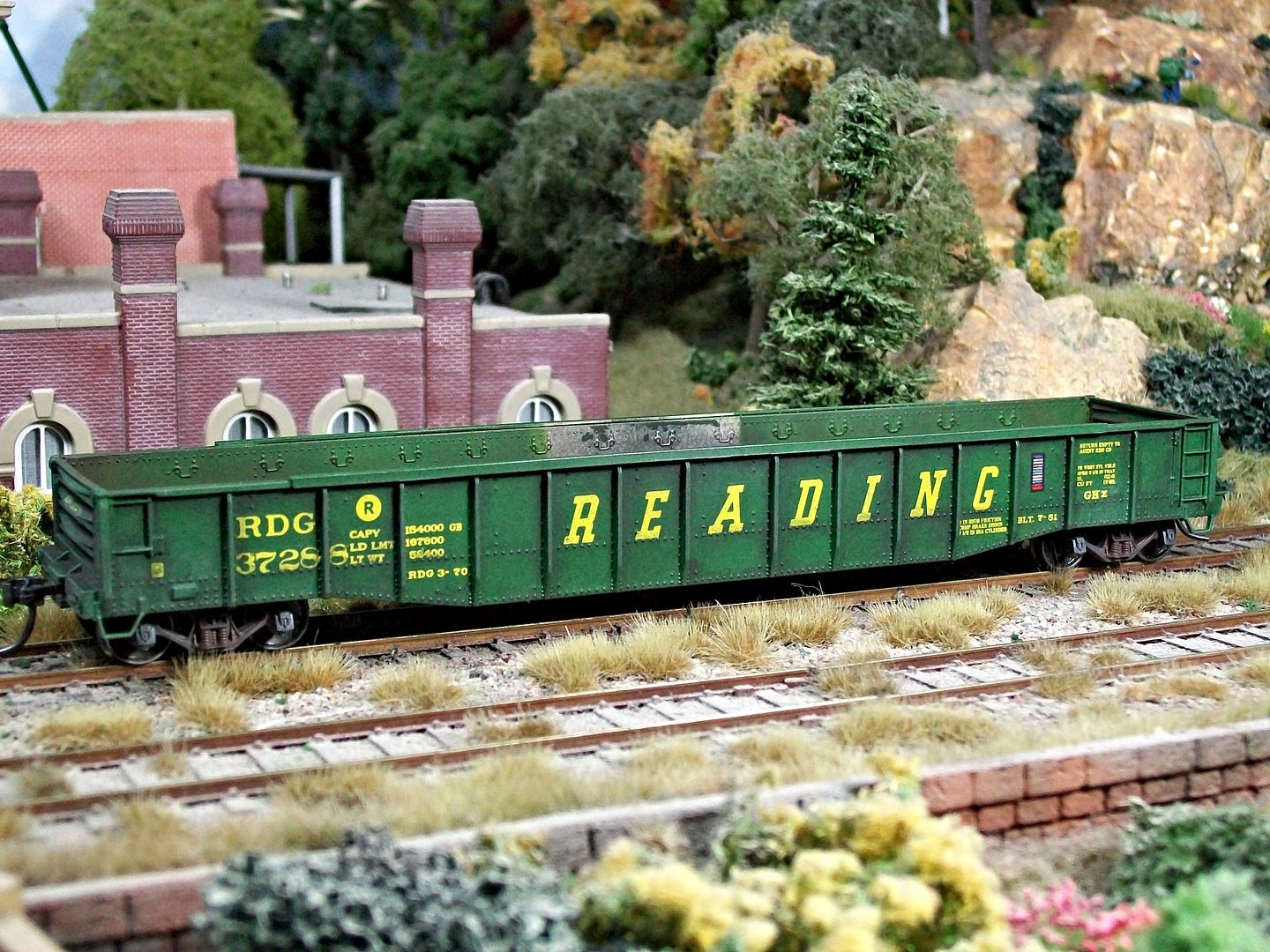

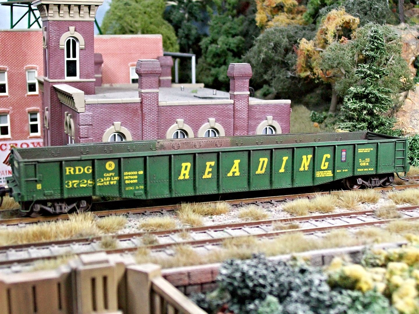

My next two units were class GHz's (37200/299)Both units are MTH offerings that were decorated for the RDG.I did not like their application of the RDG speed lettering so both received a bath in Scalecoat's paint remover.I used the same process and materials that I applied to my GHw.I have one more MTH model that will receive the same transition.
Picture of the one before coupled to the two completed models.
GHz 37282 sides 1 and 2.
GHz 37288 sides 1 and 2.
Don't forget to add some weathering to the inside of your gons.Makes for some interest when riding emty.
Units loaded with wire coils.
Coupled to a P2K model I did years ago.

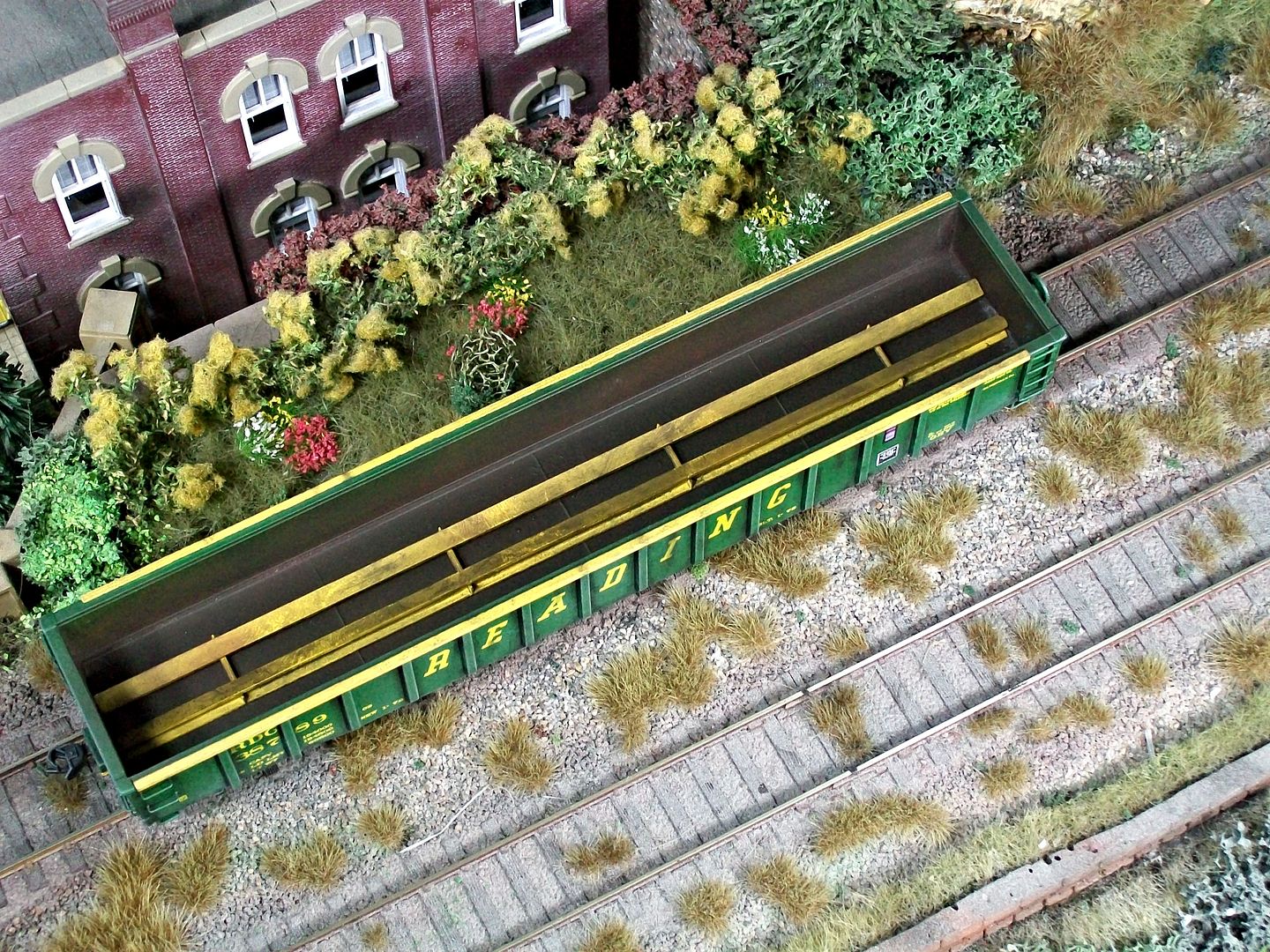

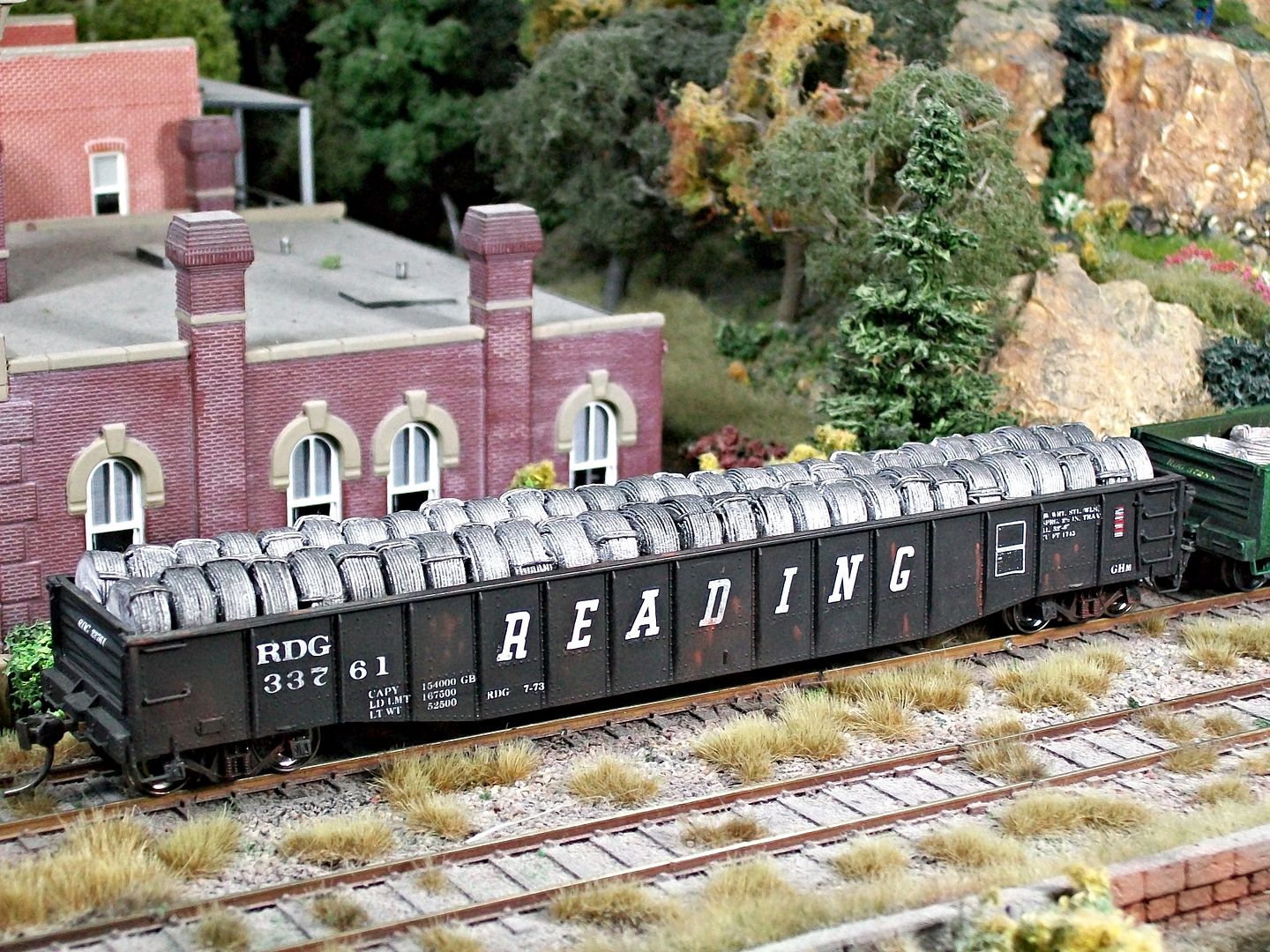

My next project was to do a RDG class GHy-2 (38700/799).I choose the Walther's offering,I compromised,The model has 14 ribs where the RDG's had 13 rib supports.The unit was decorated for the GBW.Instead of giving it a full bath in the SC paint remover I dab on the same to the lettering and wiped off the print,I then washed it with warm soapy water and rinsed.Once dried I painted over the GBW yellow with SCII RDG green.I did apply the extra bracing on the top chord using the EG 291 angle before painting.Again,same procedure as on the other gons.
My GHy 38789 side 1 and 2.
The model does come with bracing for adding steel coils if you so desire.It come painted in the color of the car,I chose to leave it in the GBW yellow.
Till I get some Walter's steel coil loads I added this load from Chooch.
